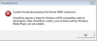

    BUT! It's playing 4:3 instead of 16:9 and I cannot find anything in the settings (none of which I understand) to change it. My freebie editor FREEMAKE cannot seem to change it, VLC can, or course. I have to add "yt: stretch=16:9" (had to put a space between : and s, otherwise it turns into a smiley) to the tag box in YouTube, but would like Jaksta to give me the correct aspect ratio in the first place.
    I tried Virtual Dub but it cannot even open the file:
