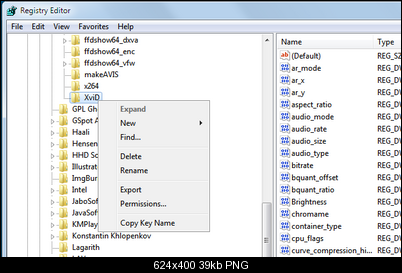

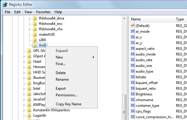

  4. Use RegEdit. Right click on XviD in the left pane and select Export. That will create a .REG file. Double click on the .REG file to import it.
