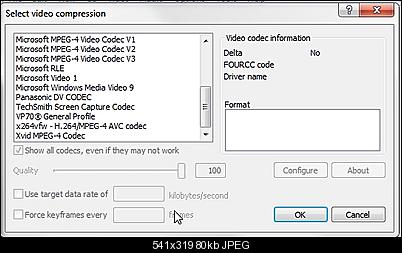

    As hech54 pointed out, Virtualdub usually only saves as an AVI file compressed in one of it's VFW encoder formats as:
Name:	ScreenHunter_485 Apr. 06 12.02.jpg
    It is possible, however to save as an MP4 file, if this is what you mean by Mpeg4. This is an excellent link to set Virtualdub up to save as MP4 .
    http://frapsforum.com/threads/virtualdub-save-direct-to-mp4-fraps-to-youtube-with-exte...encoders.2446/

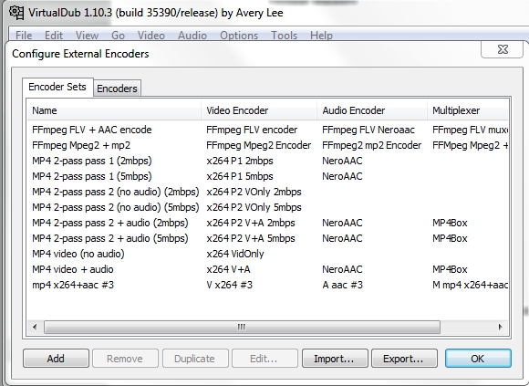

    If anyone decides to read the external Encoder guides from the links provided here and are looking for a VDPROF to import into VirtualDub, I posted a composite of several that allow saving to MPEG2, FLV and MP4 with the following specifications:
Name:	ScreenHunter_494 Apr. 20 23.03.jpg
    You can find the link at Budmansite.com and follow the VirtualDub link and it is called All_formats.vdprof or download from
    https://files.secureserver.net/0sFqOuh9VjD8u5 directly. You will still need MP4Box, NeroAAC, and X264 encoders for the MP4 formats as well as FFMpeg for the FLV and MPEG2 formats. This VDPROFS is setup for X264, Neroaac, FFmpeg and MP4Box all to be in the "C:\Standalone\VirtualDub1103\tools" folder You should only need to alter the program locations in each encoder/multiplexer if yours are somewhere else. I tested all of the enclosed scripts on my Windows 7 machine.

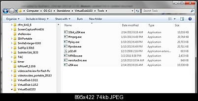

    It's recommended to create a folder in C:\ called Tools to put all your encoders in. It makes it easy to find all the encoders and makes it easier to share your profiles with everyone else.

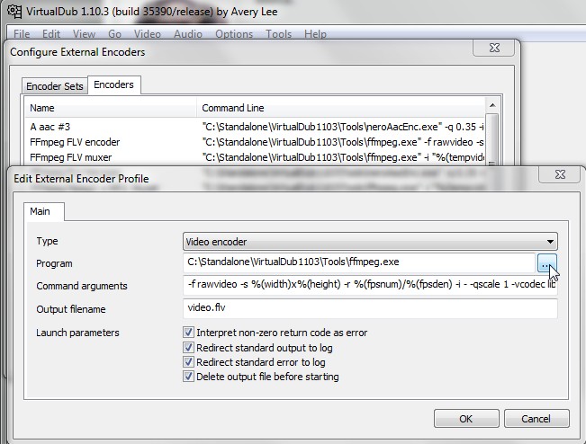

    Since I use FLV a lot, I experimented until I got it to work with FFMpeg and thought others might like it too. The quality seemed to suffer, however until I added the -qscale 1 to it. Now the bit rate and quality seems to be about the same as the source.
    I also posted what I'm trying to write as a comprehensive VirtualDub install, making it work, errors people might run into, fixing the errors, conversion and using external encoders. I put a lot of information that is missing for all those who installed and then got error messages trying to load or use it as well as shortcuts and tips marked in Red.
    It's a work in progress at the moment but I think it is quite usable so if anyone wishes to peruse it and make suggestions or corrections, it's on Budmansite.com under VirtualDub and marked with an "*" or the direct download link is https://files.secureserver.net/0smH4X5fcl7OS7 It's in PDF format now to reduce download size. The actual VDPROF is also missing from the end for the same reason but is also downloadable from the link https://files.secureserver.net/0sFqOuh9VjD8u5. (<--Updated Link to Updated File)
    UPDATE: There was an error in the vdprof under the command line for the FFmpeg2 mp2 Encoder which had -vcodec mp2 instead of -acodec mp2. The vdprof still worked fine as a -vcodec but I corrected the error and retested as well as correcting the links in the 2 posts above.
    Last edited by Budman1; 5th Jun 2013 at 10:15. Reason: Updated link to Updated VDPROF

  21. Member Budman1's Avatar
    Jul 2012
    NORTHWEST ILLINOIS, USA

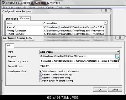

    I'm not sure what you mean "portable"? If you mean to be downloaded and uses "as is", probably not since the External encoders -> X264, FFmpeg NeroAAC and Mp4Box most likely will not be installed in the same directory on all computers. I could install them under a generic such as C:\tools but everyone will not have that as a folder either.
    The easiest way is to import the vdprof into VirtualDub and then got to Options -> External encoders -> Encoder tab and select each line and hit edit.
    Click the 3 dots next to programs and search to your X264, FFmpeg, NeroAAC or Mp4Box and it will put that location in programs for you. That should be all that needs to be done.
Name:	ScreenHunter_08 Jun. 04 21.25.jpg
    Alternative Method:
    The last ALLNew.vdprof I posted at Budmansite.com is set for all external encoders, x264, ffmpeg, NeroAAC and mp4Box to be in "C:\Standalone\VirtualDub1103\Tools" folder. Just create the Standalone, VirtualDub1103, Tools path and put VirtualDub in the "VirtualDub1103" folder and the encoders in "tools" folder. That is how the VDProf file is set by default.
