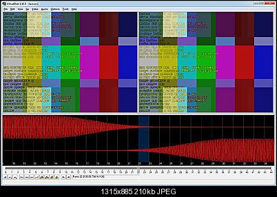

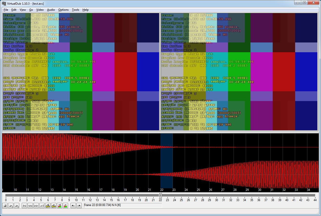

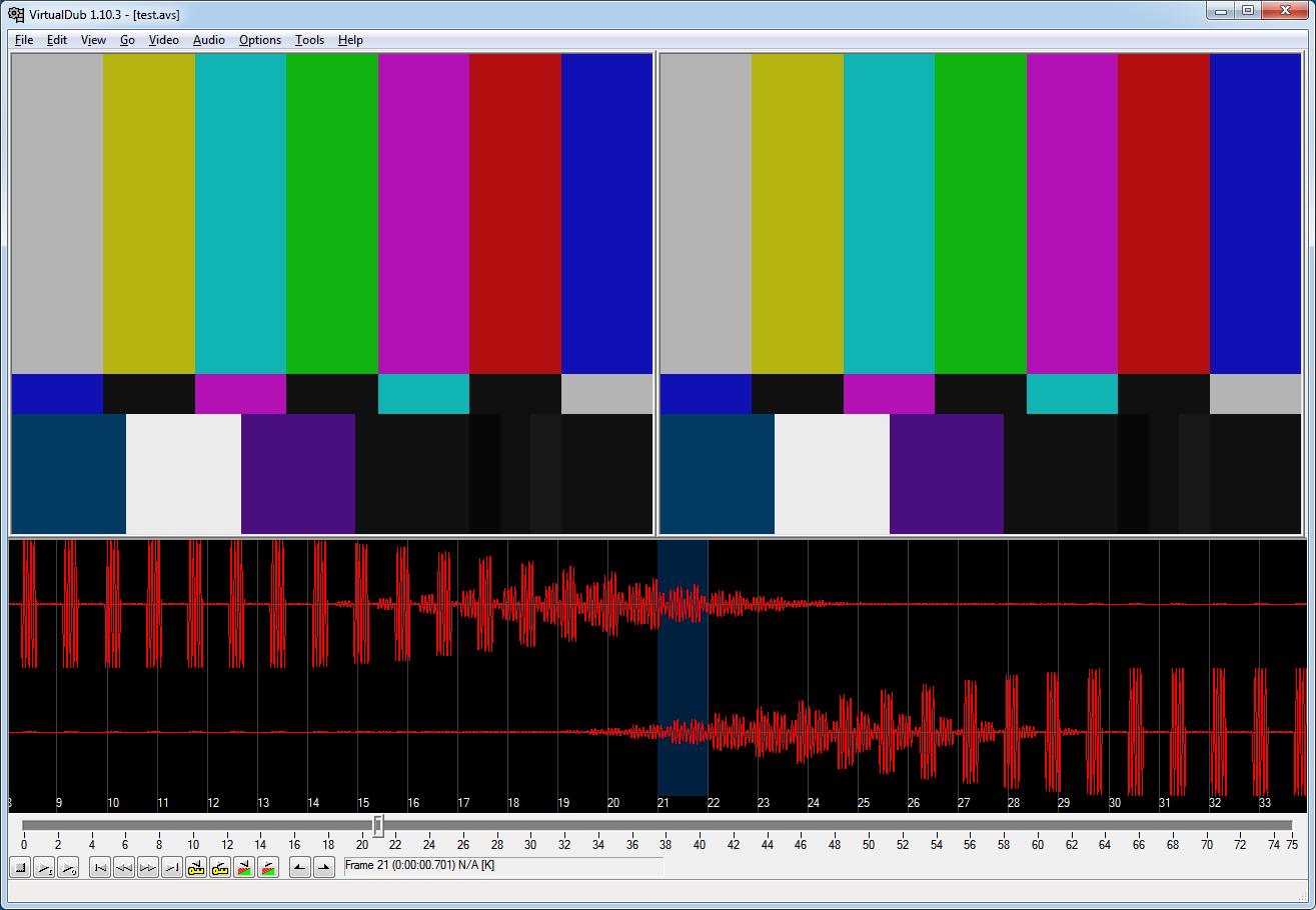

    It's been a while but if I remember correctly the basic idea was to mix several crossfades of different lengths to get a non-linear crossfade. It basically worked:

    It only appears to work because you used a static image (ColorBars()).
    If you look closely at the overlaid Info() text, specifically at the frame numbers and time stamps, you will see that each frame in the overlap region is a blend of several frames from both clips. For example, frame 21 is a blend of frames 21, 23, 25, 27 and 29 from v1 and frames 1, 3, 5 and 7 from v2. You can see the effect more clearly if you use ShowFrameNumber(scroll=true) instead of Info().
    Since the audio is processed in exactly the same way, each sample must similarly contain a mixture from several different points in time from each clip, which is clearly not what you want in a cross-fade.
    So there appears to be something wrong in the way you have implemented the function.
    Since I don't yet fully understand what you were trying to do, I can't say where the error is.
    I'm not sure why the audio (unlike the video) actually does give a smooth fade (as shown by the display). Perhaps it is because you have a fixed frequency tone being mixed with different phases of itself and producing some kind of interference pattern(?).

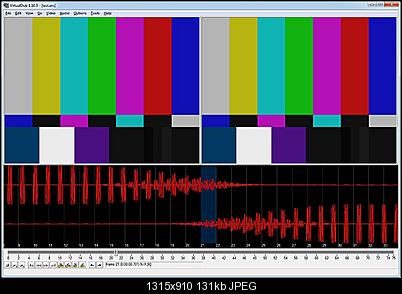

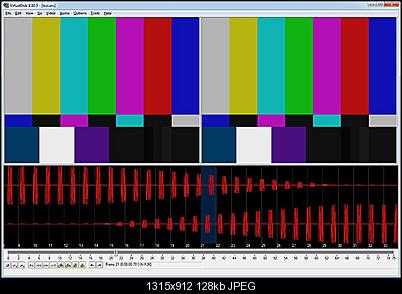

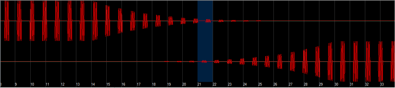

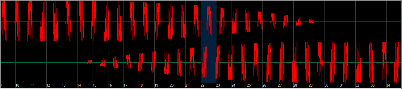

    I came up with a demonstration of the problem. I created clips with short tone bursts then ran it through the function:
    Instead of the burst simply decreasing or increasing in amplitude you can see the overlap. With a proper linear audio crossfade you get the expected:

    Interesting test, and quite revealing.
    By contrast, I would expect your other version from post #30 to work properly:
    Dissolve(FadeOut(v1,16).FadeOut(16).FadeOut(16), FadeIn(v2,16).FadeIn(16).FadeIn(16), 22)
    or perhaps better:
    Dissolve(FadeOut0(v1,16).FadeOut0(16).FadeOut0(16), FadeIn0(v2,16).FadeIn0(16).FadeIn0(16), 16)
    And similarly, my 'parabolic' crossfade from post #34:
    MixAudio(Dissolve(v1,v2,16), Dissolve(v1.FadeOut0(16), v2.FadeIn0(16), 16), 2, -1)
    This has the property, often wanted in an audio cross-fade, of a slower fall-off at the start of the fade-out and a faster rise at the start of the fade-in, maintaining the overall volume (output power) approximately constant (unlike a linear crossfade, where overall volume is 3db lower at the midpoint).

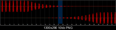

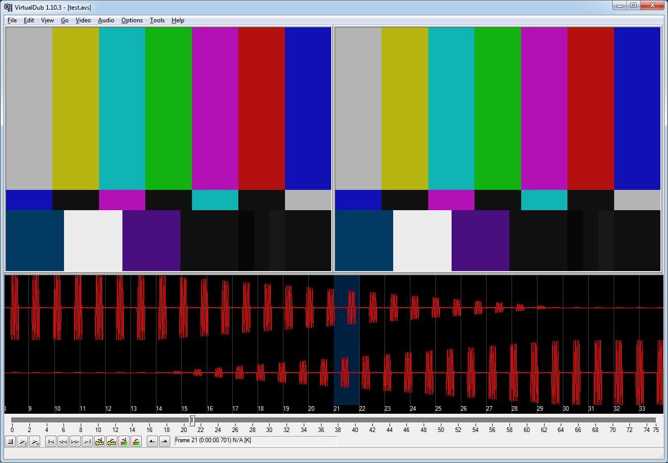

  15. Gavino's second ParabolicCrossFade():

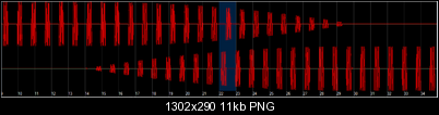

    Dissolve(FadeOut0(p1,16).FadeOut0(16).FadeOut0(16) , FadeIn0(p2,16).FadeIn0(16).FadeIn0(16), 16):

    Jul 2009
    Spain
    You're right - in general, you wouldn't want to reduce the volume outside the crossfade.
    However, applying a fixed reduction over the crossfade will lead to a discontinuity at its ends.
    Better would be to adjust the mixing factors inside the function via an extra parameter.
    function ParabolicCrossFade(clip c1, clip c2, int n, float "factor") { # third version
      factor = Default(factor, 2.0)
      d = Dissolve(c1, c2, n)
      df = Dissolve(c1.FadeOut0(n), c2.FadeIn0(n), n)
      audio = MixAudio(d, df, factor)
      AudioDub(d, audio)
    The default factor (2.0) gives the same effect as before, with a 'flat' parabola at either end.
    To avoid clipping, 'factor' can be reduced to somewhere between 1.0 and 2.0, with 1.0 giving a completely linear crossfade.
