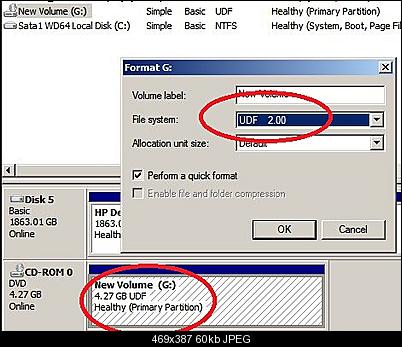

    My PC burner is DVD-RAM capable.
    Using Windows7 Disk Management, I can format Panasonic brand DVD-RAM OK.
    The Panasonic DMR-ES20, recorder seems to have no problems with them.

    There's no option in XP for UDF2.
