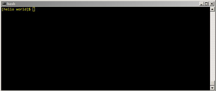

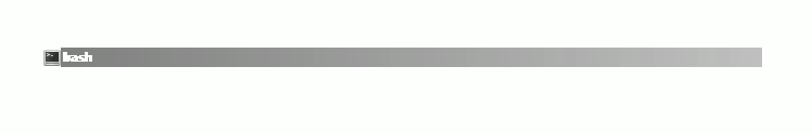

  3. I took some screen caps. The first image captures the first frame of the pip (standalone). The second image (cropped) captures the output of the Avisynth script (first frame). Maybe I'm doing something fundamentally wrong. I'm editing my script (test.avs) and all I'm doing is double clicking that file (after saving) and Windows Media Player pops up and shows the second image below.

    pip.avi is a screen capture video of a terminal screen...I run a program that outputs to standard out, the program last for like 7 seconds or something. I used virtualdub for the screen capture, and it was not prepared with alpha channel (transparency).
    The base video is about a 5 min tutorial like video and the pip is suppose to show a demo of an example. All I need is for the pip to fade in and fade out at the right time. The pip video is just a terminal window with black background. I capture other parts of the pip if that helps.
  11. First thing is first, as Scott recommended, make sure you can even open a basic overlay script, to rule out avisynth install problems, then go step by step. I don't know how you got that 2nd screenshot. You don't need showalpha() channel for this, unless your overlay has been prepared with alpha channel
