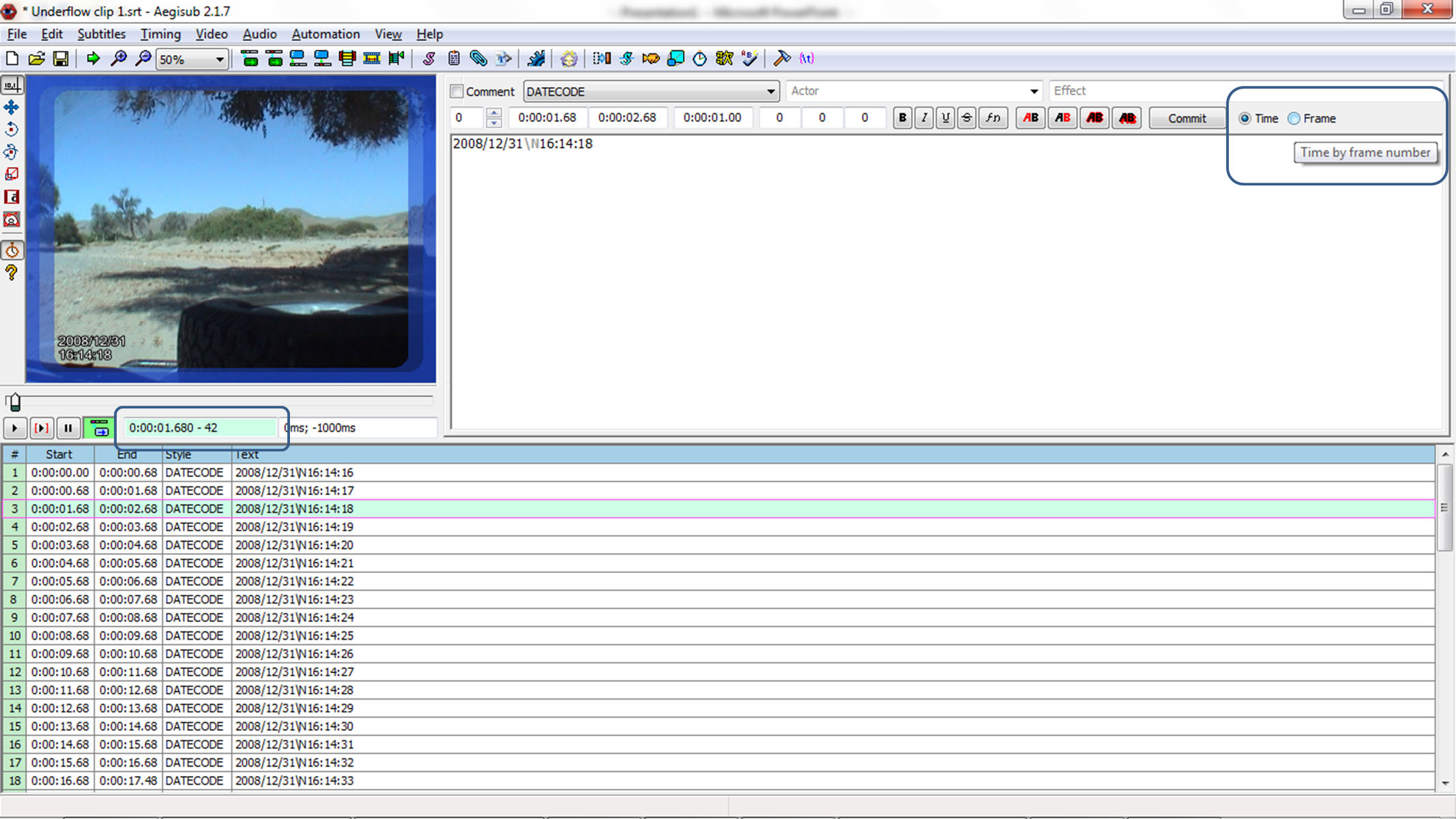

    Originally Posted by loninappleton View Post
    Can I analyze this with frame rate rather than time stamps?
    If you perhaps mean frame number, see highlighted areas attached. I'm using a non-current version so your screen may look slightly differently.
    Cheers,
    Francois
