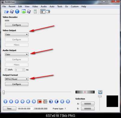

  21. aBigMeanie aedipuss's Avatar
    Oct 2005
    666th portal
    avidemux set as in picture.
    then click save video icon in upper left. navigate to where you want it and make sure to give it a name that ends in .mp4
  22. Originally Posted by aedipuss View Post
    avidemux
    Didn't do the trick either I'll upload my raw recording to my dropbox and share the link, Maybe you could take a quick looksy at it? Iunno :/
    I'll post the link when it's doen, the file is huge xD

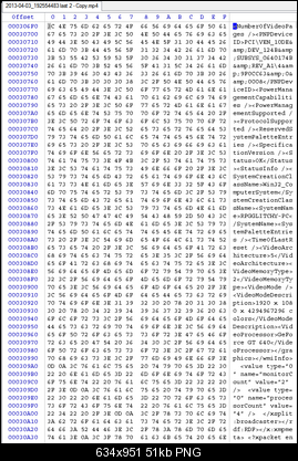

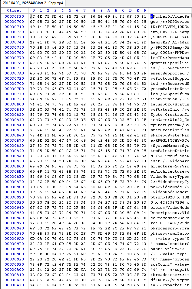

  24. aBigMeanie aedipuss's Avatar
    Oct 2005
    666th portal
    sorry but what's in the file is not a video. there are parts of lots of different files. open it with a hex editor and you'll find things like this.
  25. Originally Posted by aedipuss View Post
    [Attachment 17109 - Click to enlarge]
    oh dear god... So It got mixed up with stuff while moving? I guess it's lost then :/
  26. aBigMeanie aedipuss's Avatar
    Oct 2005
    666th portal
    yeah i'd say that external drive is suspect. i wouldn't use it for anything important.
