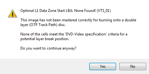

    My first inclination was to extract the ISO to HDD, then make appropriate adjustments to resolve this error. But, what are those adjustments ? If it was just a matter of the size, I would run it through DVD-RB. But the ISO is only 6.6 Gb., so that shouldn't be any problem for DVD-9, and accommodating the layer break. I'm hoping the solution may be more accessible (something like Fix-VTS ?), rather than having this become some major job. I had been expecting this puppy was ready to burn . . . .
    Alternately, it would suit me just as well to split this off to two DVD-5's, so long as I can then burn them and have them be playable on a standard hardware player.

    Just to be absolutely sure, I wouldn't try just any simple fix, I'd reauthor.
    So, you'll need to rip the contents to HDD and convert the VOBs to MPG (hopefully it might all be one title/file when converted). Those are your new source assets now.
    Then re-author using a known good authoring tool (one that doesn't mess up layer breaks). Then burn (either with Imgburn or the tool that comes with your authoring app).

    Well, it may actually be possible to fix this in a different, quicker way. I'm not saying that for 100% certainty this will work, but it might.
    Mount the ISO with Daemon Tools or something similar. Rip it in File mode with DVD Decrypter to your hard drive. Use PgcEdit to create a new ISO image from the ripped directory with a break point it lets you set. If PgcEdit can't find a layer break, you'll have to reauthor.
    The error message as such is not clear to me that it's truly impossible to find ANY cell to serve as a layer break so much as the current ISO isn't set up in a way to do. However, I may be misunderstanding it and it may indeed require reauthoring to fix.
  4. Easier still, mount the ISO in whatever and just point ImgBurn's 'Build' mode at the virtual drive.
    You can't move (pad) stuff when it's in an ISO, hence why you'll see this error more frequently when working with ISO files rather than the raw VIDEO_TS folder.

    The job turned out fine. LIGHTNING UK"s suggestion (in Post #4 above) did the trick. I don't know exactly where someone must have gone wrong in creating that ISO, especially since 6.6 Gb should not have been enough to run out of cells / space for DL. (They had at least an extra 1.1 Gb. of space to play with.)
    I myself have on more than a couple occasions goofed up and made a DL-ready job (not ISO, and most probably using AVStoDVD) a bit too large, with the result that ImgBurn just gave up, with that dreaded "Oh NO !!" In that case, I usually had to do it all over again, scaling back the total size.
