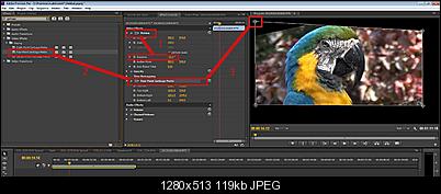

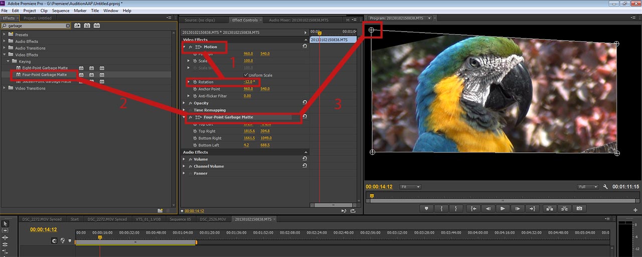

  10. Here, quick guide.
    1) In the effects controls rotate your shot to straighten
    2) Locate the garbage matte effect and drop it on your clip
    3) Adjust the corners of the garbage matte to hide the triangles and create a black border
    The effect can be saved as a favorite for reuse. No resizing, no intermediate render.
