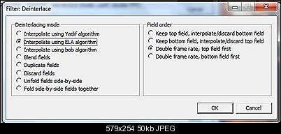

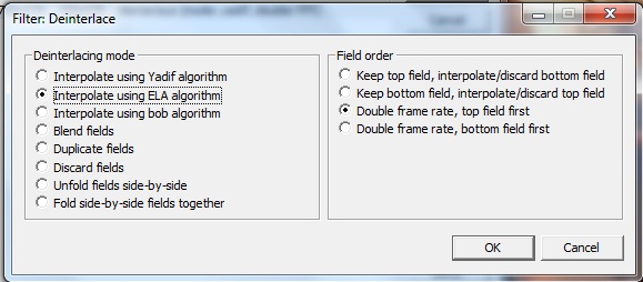

    i don't find this filter:
    in VirtualDubMod..
    what can i do?
  2. That is VirtualDub's built in deinterlace filter. It changed a few years ago. VirtualDubMod is based on a very old version of VirtualDub. So you can't add that filter to VirtualDubMod. You have to use VirtualDub instead. Unless you want to get the source code for both programs and integrate them. It will probably be a major job because VirtualDubMod doesn't support double frame rate changes in filters.
  3. Originally Posted by jagabo View Post
    That is VirtualDub's built in deinterlace filter. VirtualDubMod is based on a very old version of VirtualDub. So you can't add that filter to VirtualDubMod. You have to use VirtualDub instead. Unless you want to get the source code for both programs and integrate the them.
    It's complicated?
    And what is the alternative to this filter?
  4. There is no alternative for VirtualDubMod. It doesn't allow filters to change the frame rate -- so the double frame rate modes aren't possible there. Just use VirtualDub. Or use AviSynth. There are even better deinterlacers there. QTGMC, for example.

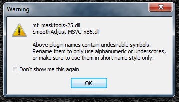

    thanks but on this version i get this massage:
    i don't know what that mean..
    i need to ignore this?
    what i download from the official site is version 2.0.2 and it's look the same thing and it does not give me that massage..
    and is it possible to change the gui style to look like this:
    http://i1-win.softpedia-static.com/screenshots/AVISynth-GUI_1.png
    i mean that the text area will be on the right side, the video on the left...
    i don't like the current mode..
    if not then even just make the edit text area/video preview to be in a different window.
    I'd be happy if i can do something about it...
    thanks you for the help

    In this case, the "Mod" version is pretty official and has many updates, now at 2.4.2. The original programmer stopped development a couple of years ago with that 2.02.
    I think it doesn't like the names of the dlls. Try renaming them, remove the hyphens.
    But that's just a guess.

    Aug 2007
    Isle of Man
    [Attachment 17037 - Click to enlarge]
    This kind of message is controlled by the option (on AvsPmod 2.4.2) Options->Program settings...->Misc->'Show warning for bad plugin naming at startup'.
    Cheers,
    Francois
  14. There's nothing wrong with hyphens in AviSynth plugin names. Just select the "Don't show me this again" option and press OK.
