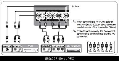

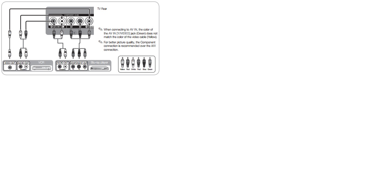

    It looks to me that, although you have posted a picture showing the sockets as labelled Audio and Component out, these are to be connected to the audio and component out on an external device so would be connected to inputs and not outputs. According to the manual, the TV is correctly marked, Component/audio In.

    As your TV doesn't even have a headphone socket, unless you want to open it up and connect to the speakers, then you can't do what you want to do.

    From what I can discover, the red and white jacks on the back of your TV are audio in (Analog) and would be used with the component video in. (Also analog) There doesn't appear to be a analog or any audio output from the TV.
    Your photo is from the BD player graphic, not the TV. This one seems to be the complete one from your manual:

    If all of this is true, then you would need a surround sound receiver with a HDMI pass through that could output the digital audio from your BD player.
    Or you could use the analog out from your BD player to a analog speaker setup, such as computer speakers to get sound. But I don't see how you can get sound from your TV set.

    The picture you have posted, are the Audio and Component "Outs" of the BluRay player, not the TV

    Thank you, I realize that...my intention was to show a red and white labeled "audio out", the BluRay player was just in the picture and not the primary focus
    of my inquiry.
