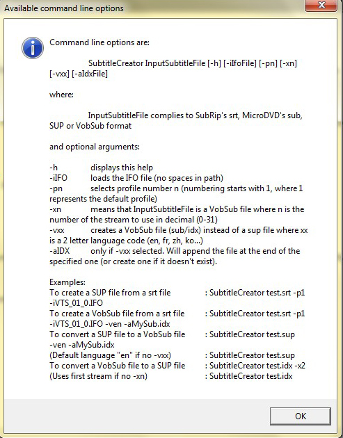

    2) Where do I find an explanation of the command line options window? How am I supposed to use these?

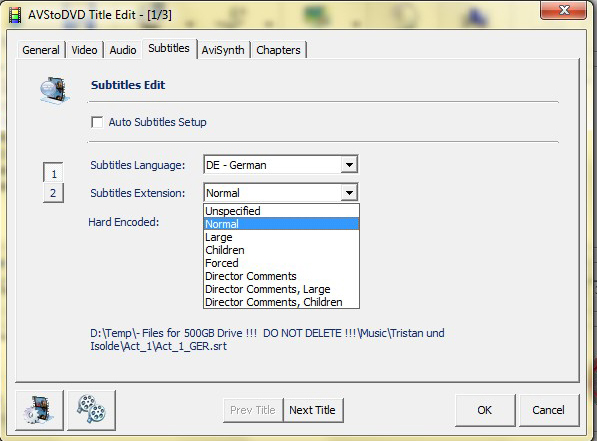

    Just one other small point: when I burn the VOBs to disc and play it on the TV, the subtitles selections are all labelled 'ENG'. In other words, if I have English, French & German subtitles, on the TV thy are all labelled ENG instead of ENG, FRE & GER as I scroll through them. Is that a function of the DVD player - the srt files are titled appropriately - or have I not set something in AVStoDVD?
  6. You can customize the languages for every subtitles track. Go to 'Edit Title'/'Subtitles', toggle off 'Auto Subs Setup' and select the proper language for each track you have.

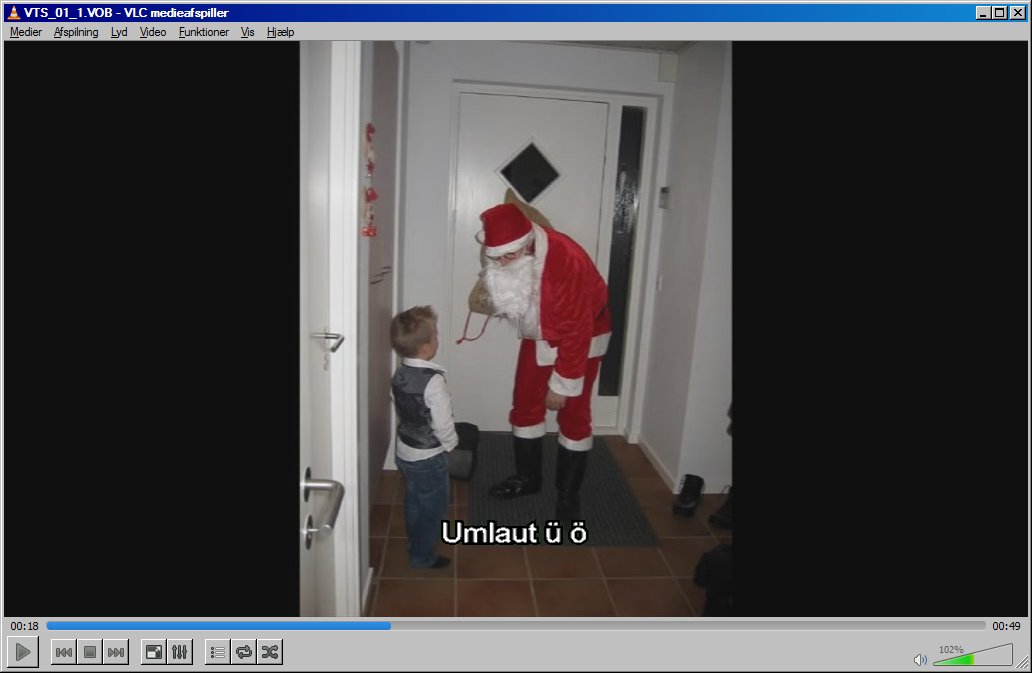

  11. I have no problems with umlauts using a UTF-8 encoded SRT file - neither softcoded nor hardcoded.
