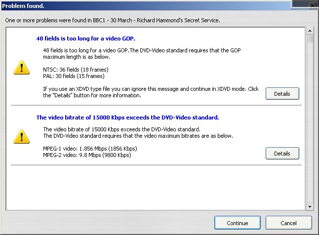

    Is it really that big of a problem?
    In my experience the DVD players i have used had no problems with non standard/long GOP sizes?
    I just ignore the warning from my DVD authoring program (TMPGEnc DVD Author) and author/burn it as is.
    Example from a PAL BBC1 DVB-C recording from my dutch cable:

  4. Originally Posted by The_Doman View Post
    Yes, I know about it ("Womble Mpeg Video Wizard" allows ignore GOP size too), but I never don't know on which DVD players will be my created DVD discs runned and I need 100% certainty these discs will play without problems.
