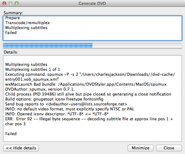

    I extracted the idx/sub using BDSup2Sub as described. It didn't work with DVDStyler as you can see. Next I'll try it with MPEG Works 5 and see what happens.
    UPDATE:
    Okay, so I transcoded the movie using M2W5 and then used it to input the extracted/converted sub files. The file was accepted and the process started but finished in about 10 seconds with the output being a 0 byte file. So then I downloaded an .srt file with the movie subtitles. Again input was accepted and this time it processed the file producing a movie with subtitles. The problem however is that the subtitles were several minutes out of sync with the movie. I'm not sure if that's the fault of the .srt file or M2W5. So far I still haven't found a working solution. The developer of M2W5 has been working with me to find a solution, and I'm confident that sooner or later this will happen.
