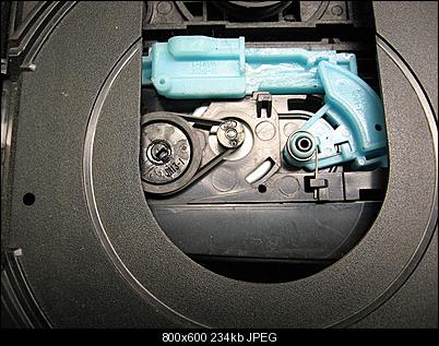

  15. I'm a Super Moderator johns0's Avatar
    canada
    How about buying a new dvd burner and putting it in an external case,won't cost much more.

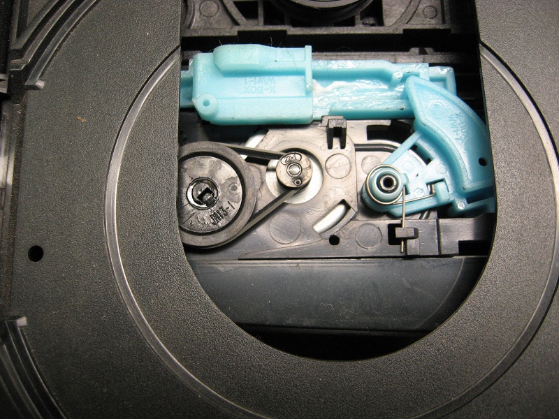

  18. Banned
    Jun 2004
    ®Inside My Avatar™© U.S.
    The point was/is, they may not use write strategies for ANY media, even Verbatim, that are 8 years old and are NOT produced anymore......
    You just need to take the drive casing apart/off and open the tray a little as the drive mechanism is usually right at the front of the drive.
  19. I'm a Super Moderator johns0's Avatar
    canada
    Just take off 4 screws from the dvdrw housing and lift off the cover and eject the tray and you will see what Noahtuck is showing in the picture.
