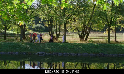

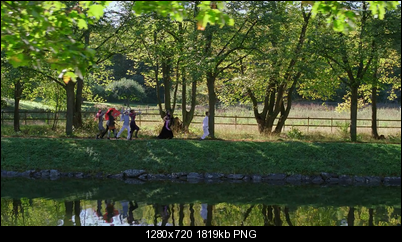

    Maybe some pictures and examples will help you to understand . These were 1280x720 8Mbps 2pass encodes . Both same enocoding settings, except 2nd used intra . Note this is a b-frame for the long GOP encode (the lowest quality frame), an I-frame to I-frame comparison would have shown even bigger difference
Name:	250 multihex,subme9, Rec709.png
Name:	250 multihex,subme9, Rec709 , INTRA.png
    In most situations and conditions, that "50% worse" is probably very conservative estimate. I would say more close to 1/2 the size with similar quality when using long GOP with b-frames with x264
    You are using CRF rate control, so you don't know what the end bitrate will be until it's done. It's only a "rough" estimate of "quality" , but if you run a CRF encode vs. CRF using intra, the intra enocde should be signifcantly larger

    Here is a quick test with a SD DVD, just 1000 frame sample using CRF encoding.
    -crf 15
    14.1MB
    -crf 15 -g 1
    27.5MB
    2.8Mb/s vs. ~5.5Mb/s . A quick visual check shows they are roughly the same quality. That's about 1/2 the size. Your test would probably give 4-5 GB instead of 8GB . "not too large" is subjective, but 2x the filesize is definitely significant
    For these reasons, intra isn't used as a end delivery format (maybe an intermediate, but not something you deliver or embed in a webpage) . It's not good enough compression

  27. OK , but did you compare without -g 1 ?
    yes, not with big files.. only small files.
    i know what you say to me.
    and i sow those results on my eyes.
    Indeed, this is make it to be poor compression..
    but it solve this:
    in sony vegas Without having audio sync problem.

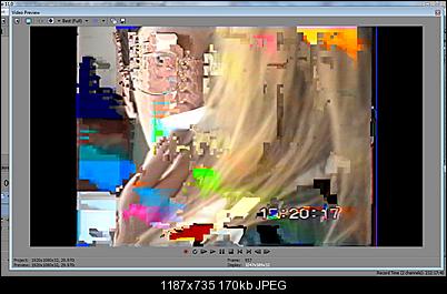

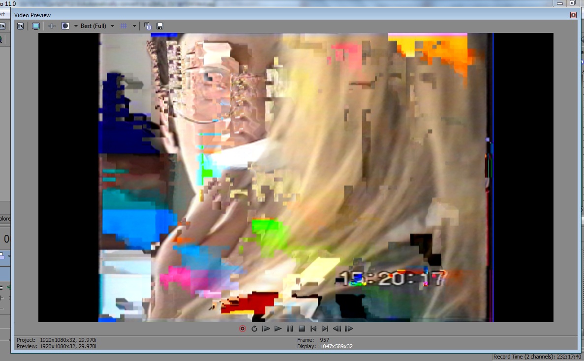

    Test Failed:
    But what is the intended goal? Why would you want to re-import into vegas ? Isn't all the editing done? Is this for viewing or other reason (intermediate file)?
    Tape recording as much as possible and then work on most of them at one stage.
    It speeds up the process significantly.
