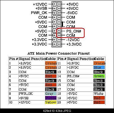

    The Reset and PWR switches are the same, momentary type. I have switched the Reset switch leads to the PC PWR terminals before to test the PWR switch. You can also short the PWR switch terminals together on the front panel connectors to send the PWR on signal to the MB.
    The way the PWR on switch works is it connects to ground and that sends a signal through the motherboard and actuates a switching transistor to connect pin 14 of the ATX PS connector to ground. (Usually pin 13 or 15) This turns on the power supply. You can also hook pin 14 of the ATX PS lead directly to ground and the PS will turn on.
    A MB will usually start up without RAM or cards, but you should get a lot of beeps and the PS should run. It obviously won't boot as that's a function of the OS.
    It sounds like it might be a MB problem. And those aren't really practical to test.

    @redwudz, are you saying I can connect the POWER SW 2 pin leads to those 2 red connectors to short it and try to turn it on that way?

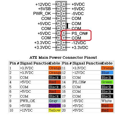

  29. @nelson37 This "siren" I only heard momentarily as I figured something was wrong so I turned the power off pretty much immediately. The siren and spinning of fans came on when I flipped the switch on the PSU and not from the power button or shorting the 2 pins, which did not work.
    Just to confirm, you guys wanted me to short the shown in diagram E pin 6 and 8 correct? Or were you guys talking about the ones in Redwudz's pic? In any event I tried to put a jumper on pin 6 and 8 and that didn't work after removing it momentarily in getting the power on. I also tried the screw driver approach and that didn't work either. The sequence of event was: Was working > Stopped working > Fans and PSU came on after flipping the switch and siren came > Power led on mobo, cpu fan still functional but unable to turn on power by any means.
