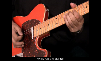

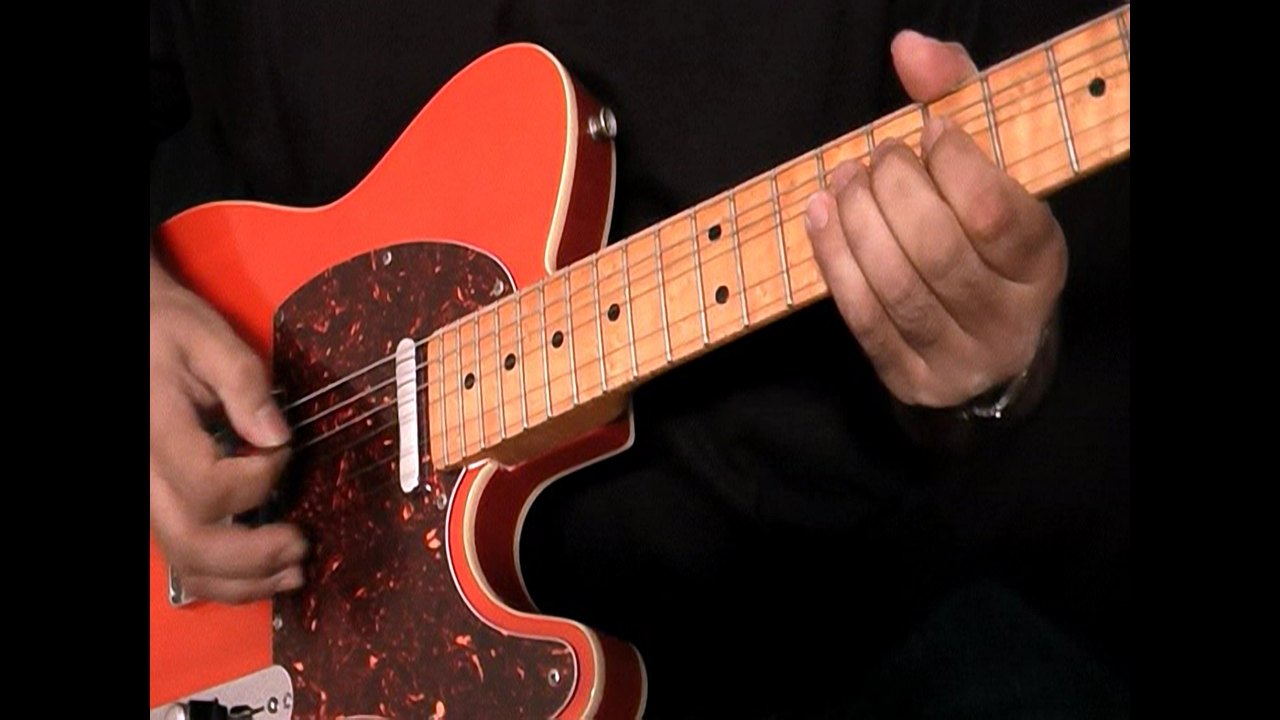

  9. There are multiple issues, but the biggest concern regarding "quality" is the interlaced upscaling quality isn't very good in InstantHD Advanced or any NLE (because of poor deinterlacing quality) compared to some avisynth deinterlacers like QTGMC - as a result you will get upscaled deinterlacing artifacts (aliasing or "jaggies").
    e.g 4:3 interlaced 720x480 source, upscaled to pillarboxed 1280x720
    InstantHD Advanced (in AE, but should be the same in premiere)
Name:	instanthd advanced.png
    QTGMC, NNEDI3_RPOW2
Name:	qtgmc, nnedi3_rpow2.png
    But avisynth is not as user friendly (no buttons to push, no real GUI except maybe avspmod), there learning curve at first, sometimes it's a bit of a hassle trying to collect plugins & .dll's, but at least it's free and many people are around to help with beginners.

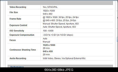

  15. Originally Posted by Yiota View Post
    I asked cameraman about 30fps and he said that camera has only this choice

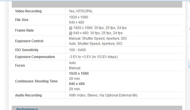

    He's very wrong. This camera has been used in major feature films and TV series around the world. It's that good. None of them used 30 fps.
    http://www.bhphotovideo.com/c/product/583953-REG/Canon_2764B003_EOS_5D_Mark_II.html
    (under specifications look at frame rate.)

    "...enables HD video recording that can capture true HD-quality (1080p) video at a frame rate of 30 fps with Face Detection and..."
    "Record HD Video The EOS 5D Mark II is unusual among SLR digital cameras in that it is capable of recording full HD video, and it's the camera's Live View function that makes it possible. You'll record video clips in full High-Definition with 1080p image quality and a capture frame rate of 30 fps with sound. Users can even attach an external microphone for recording professional-quality audio with the video, and all Live View AF features can be used when the camera is shooting video. Furthermore, users can play back video clips on an HDTV display with higher quality with the camera's HDMI Video output (optional cable required)."
  17. Click image for larger version
    Is this the same cameraman who chose SD on the nice Panasonic?
  18. Is it possible your cameraman never did the firmware upgrade from 3 years ago? (version 2.03,
    now up to 2.12)
    http://support-hk.canon-asia.com/contents/HK/EN/0400048602.html
