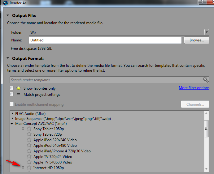

    with every version of vegas it seems to switch back and forth from sony avc to mainconcept but for version 11 i think mainconcept won. use the template for internet 1080p. you do NOT want to upload 1080i to youtube.

    Thanks for the reply. When I try to render using that template I get "An error occurred while creating the media file. The reason for the error could not be determined"
    That template doesn't show up at all when I check "Output Format" "Match Project Settings"
    Not sure what I'm doing wrong...
    EDIT: I adjusted the project properties to progressive and that template did in fact show up, it still threw up the same error when I tried to render with it though...
