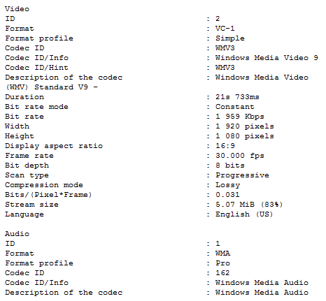

  1. I have a situation here. And I don't know who could be causing the real problem while playing the video. The video doesn't play well. It plays slow, like how a high end graphic hungry game would run on a low end system. Here are the instances and the result of playback.
    1. LAV video (QuickSync for HW Acceleration with VC1 enabled) + madVR => Choppy playback.
    2. LAV video (QuickSync for HW Acceleration with VC1 enabled) + EVR Custom==> Normal Playback
    3. LAV video (VC1 deselected under QS decoding option)+ madVR => Playback normal.
    So, is it VC1 codec of QS that is creating problem or madVR ?
    Sample Video included.
    MediaInfo included.
