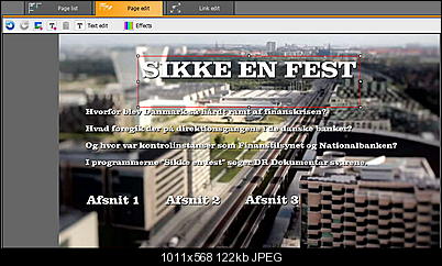

    In the attached picture, you can see the headline "SIKKE EN FEST" and the red lined text box surrounding it.
    As you can see, there is a lot of empty space inside the text box.

  2. Rather than rewriting windows, why not just move the box, or add two spaces to the beginning of the line.
    Apr 2011
    Denmark
    Problem solved in the latest update. The only issue now is that the subtitles are a little to left left and not centered.
