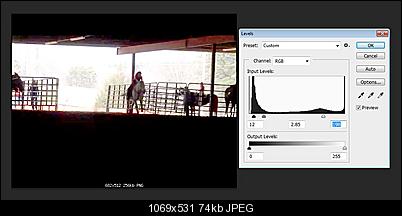

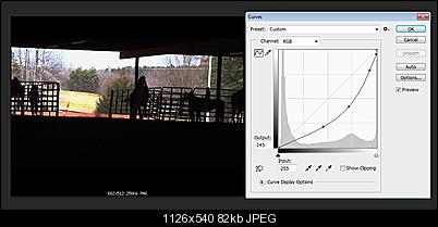

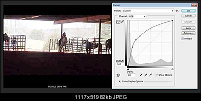

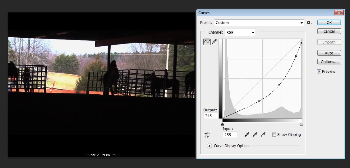

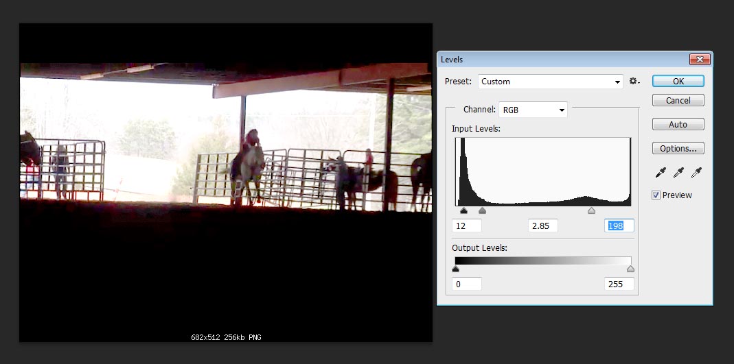

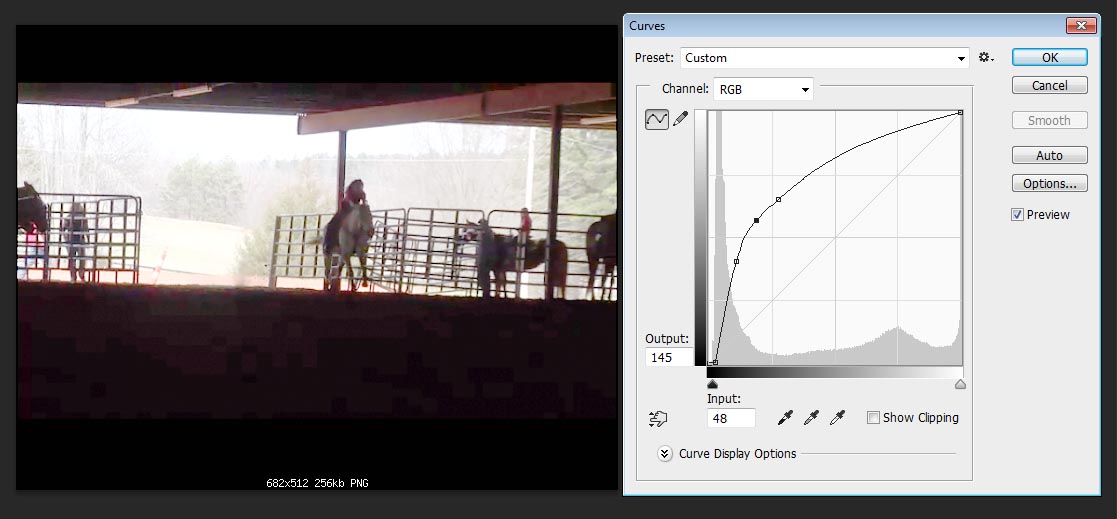

  13. Your image is about as bad as it gets because it has both blown out highlights and very underexposed darks. Additionally you want SOME parts of the highlights -- the shadows of the background trees for example, to be darker than parts of the shadow areas -- the horse for example.
    Budwzr's approach is the best for saving as much of the image as possible. He's braver or more patient than me. In this situation, I would sacrifice the highlights becuase they're irrelevant to the "story." In motion, artifacts are likely to appear because of normal differences between frames.
    The curve tool in most nle's is useful. These were done in photoshop, but the idea is the same. Here's a curve for maintaining the highlights:
    Here's a curve for maintaining the shadows, as you can see the curves overlap, so there's no way to do both at once. That's why Budwzr created layer masks based on luminance.
    An easier tool is levels, but it's not as subtle.
    The bottom line is that you don't really have the detail you need, you're digging it out of a limited range. Ideally you set your camera's exposure to the part you want exposed properly in the first place.
