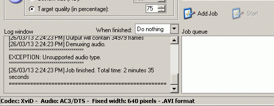

  7. I'm making the reply in notepad here and adding as much info as I can.
    There is no red error message-- my mistake in thinking about another program.
    _But_ if the .ifo is loaded, the rest of the screen greys out and I cannot proceed.
    However, moving on in the VTS sequence that begins with VTS_07_0.ifo which is the first file and where
    VTS_07_1.VOB
    VTS_07_2.VOB
    VTS_07_3.VOB
    follow, if I load _07_01, followed by 02 and 03 I can add each to the job queue and the recoding process begins. 07 is one of nine data sets and appears to contain the whole movie which I will test this evening in VLC. The other data sets from a dvd are trailers and chapter headers.
    From this test it seems that the .ifo prevents the transcode to .avi from beginning. If BUP files and so on which are not in the 07 data set of four files is needed, then more experimentation to find the right ones for the content will have to found. AGK indicates that it will recode to .avi as each file is added to the queue. The audio indicated is "0" AC3.

  8. It could be the set of DVD files you have weren't authored correctly, hence the problem opening the IFO, but if the vob files are sequentially numbered as in your example above, you only need to open the first one for encoding. The rest in the sequence will automatically be included and encoded as a single AVI.
    Here's how I prepare a DVD for encoding:
    Open the folder containing the ripped DVD files with DVDShrink. Go into DVDShrink's preferences and change the target DVD size to "custom" and set it to 50000MB. That'll stop DVDShrink from re-encoding the video. Select the Re-author button at the top. In the right pane you'll see one or more titles. If it's a movie DVD it'll be obvious which title is the movie. Drag that title from the right pane to the left.
    Switch to the compression tab and with the title in the left pane highlighted, you can choose which audio and subtitle streams you want to keep. Use DVDShrink's backup function to "backup" the re-authored DVD to a new location on your hard drive. When it's done, the re-authored DVD will consist of a single set of vob files which will be just the movie.... exactly like the first example I posted earlier. Open "VTS_01_0.IFO" with AutoGK and you're good to go.
    If it's an "episodic" DVD you can drag one or more episode titles from the right pane to the left. Use the backup function to save the re-authored DVD again and you'll have a set of vob files with a corresponding IFO file for each episode. Once again you can open the corresponding IFO files with AutoGK and you'll be encoding the episodes individually.
    I use AnyDVD to decrypt discs which DVDShrink can't handle by itself, but I always use DVDShrink to rip DVDs. That way you can open the disc with DVDShrink, re-author it as I've described above, and use the backup function to effectively rip the DVD and re-author it for encoding at the same time.
    Just make sure you change the target DVD size in DVDShrink's preferences to something large first so DVDShrink doesn't try to "shrink" the DVD to fit on a blank disc while it's re-authoring it. With the target size set to something large, DVDShrink will just copy the video and audio.
