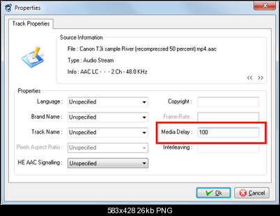

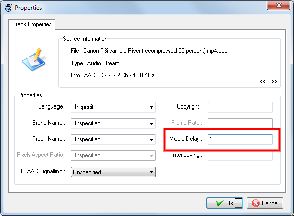

  27. I thought the MP4 container lets you specify an audio or video delay. Mp4 Muxer doesn't seem to support the feature. YAMB lets you specify the delay but I don't think the program can handle AC3 audio. And when I tried it with AAC audio it didn't add a delay.
    MP4Box (the command line program used by YAMB) appears to support the option. ffmpeg supports the option but it's another command line program:
