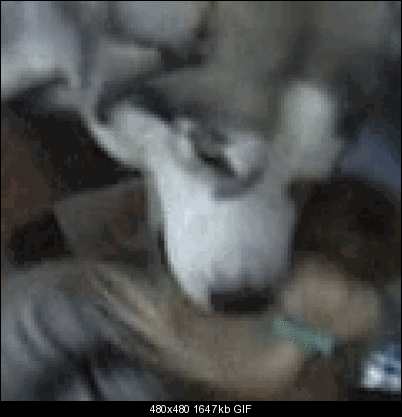

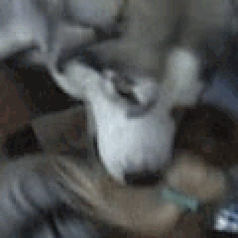

    Here's an example crop from two videos (both recorded on a DVD recorder, one at ~8000 kbps, the other at ~2000 kbps) side by side at their original size:
    By enlarge, gross details are retained, though the low bitrate image looks "rough". Now here's the same two crops interleaved and enlarged 4x (point resize):
    The damage done by the low bitrate encoding is much more obvious.
