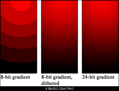

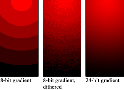

    Am I missing something here? Deblocking is disabled by default..... for reasons I don't understand.
    The problem relates to blocking. Has anyone suggested enabling deblocking yet?
    As has been suggested though, the x264 encoder would probably be a better choice. Using the default settings and a high enough quality setting (CRF value) generally produces encodes without any noticeable blocking. There's always the odd exception, but banding tends to be more of a problem than blocking. This sort of thing, but it doesn't sound like that's your problem.
