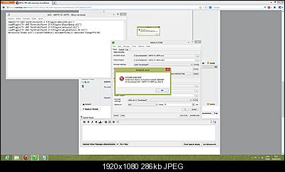

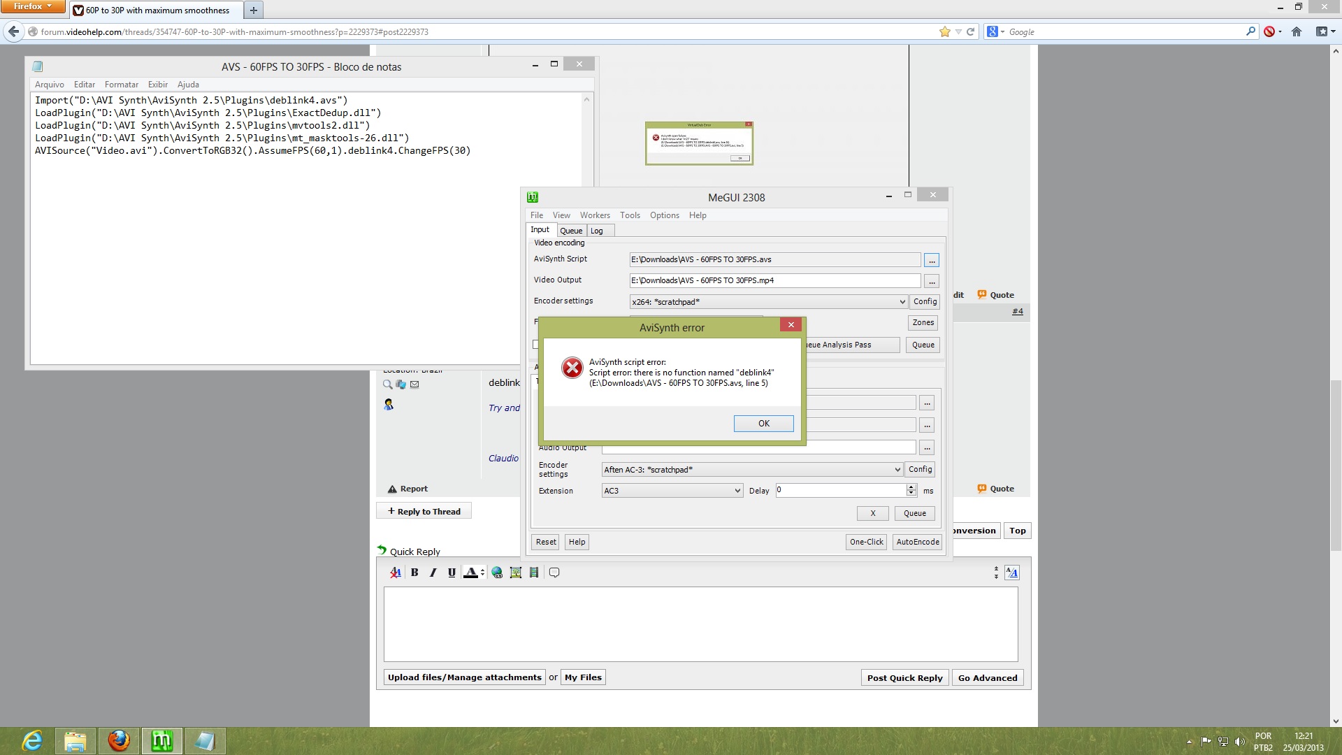

  3. Thanks for the help. I tried to use the files, but an error message appeared.

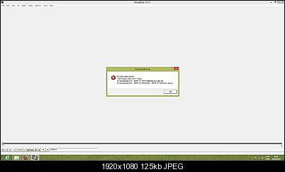

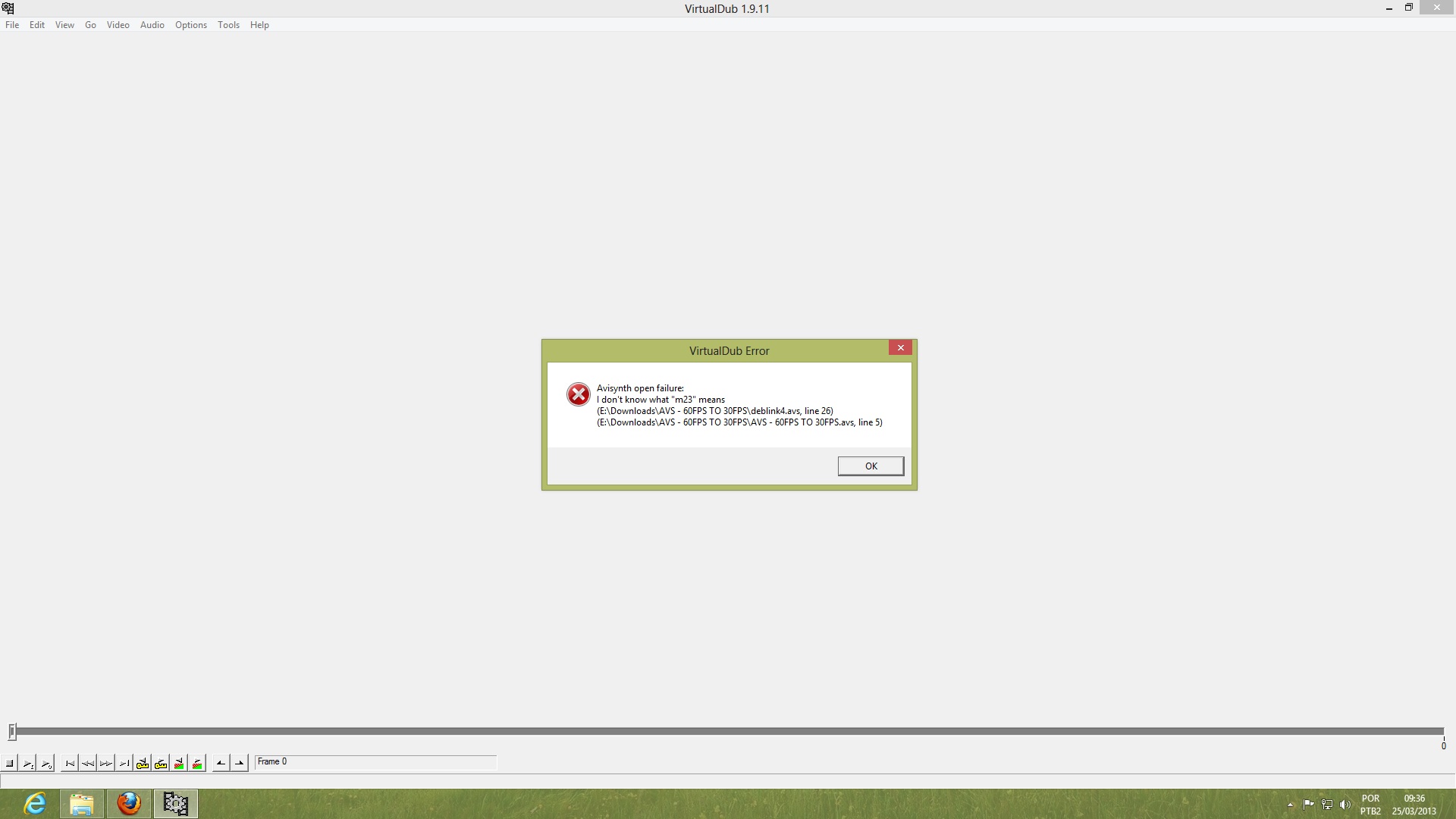

  5. Doesn't work, another error here:

  6. Open up the deblink4.avs that was posted above; The call is ng_deblink , not deblink4
    ie. Replace deblink4 with ng_deblink in your script

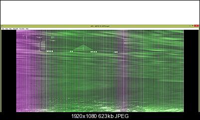

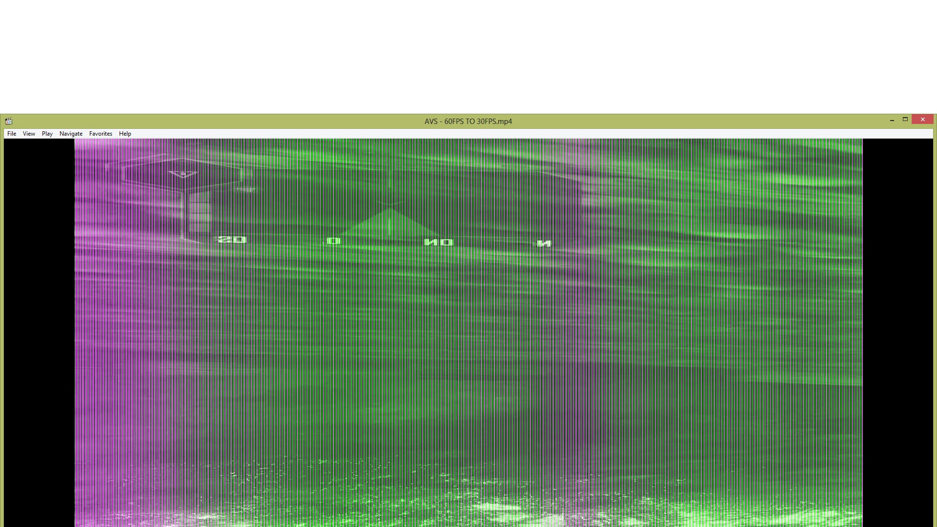

    This fix works, but here came a new problem: I can not see the video. Turned 180 degrees.

  8. Check the frame size. Some filters require mod 8 or mod 16. Also verify the ng_deblink() call is the problem. Comment it out (put a # sign at the start of the line) and see if you still have problems.

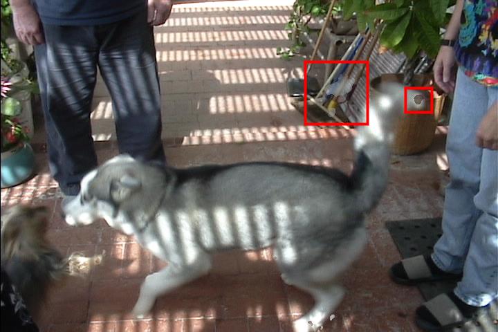

  9. Originally Posted by Cauptain View Post

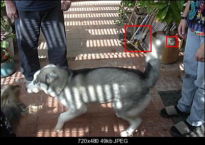

    By the way, what exactly is this filter supposed to do? I've tried ng_deblink(), with several different types of video (60 fps game caps, film sped up to 60 fps, etc.) and most of the time it returns the same thing as SelectEven(). When it does modify the picture I just see a few small ugly blotches:

    I changed the codec from x264 to xvid in MEGUI, I can now see the video. At first the smoothness of motion is equal to the other converters I've used. Result: video lag, not soft.
    Thanks for the help, but not getting the result I want. I will continue researching.
