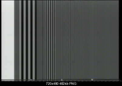

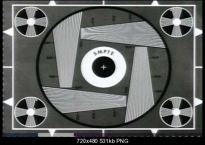

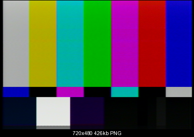

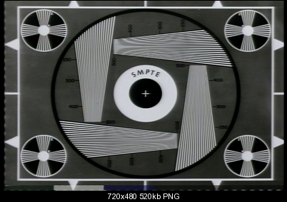

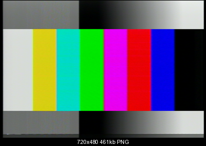

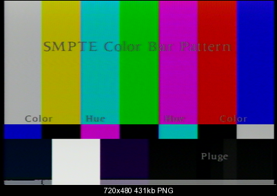

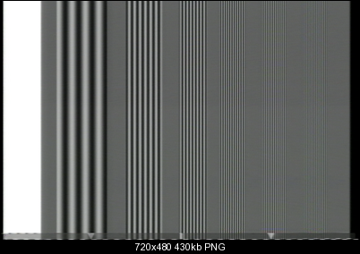

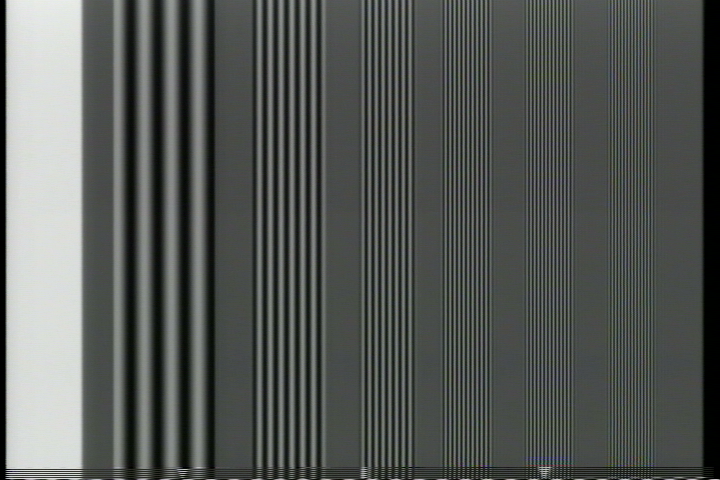

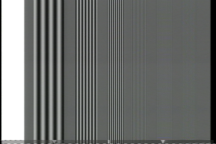

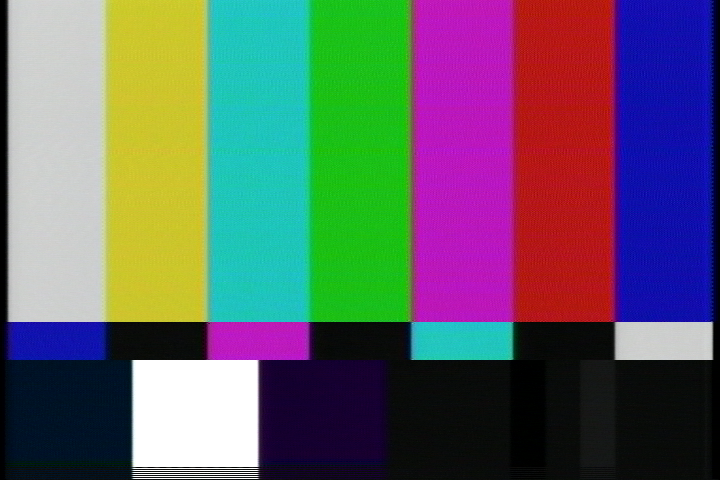

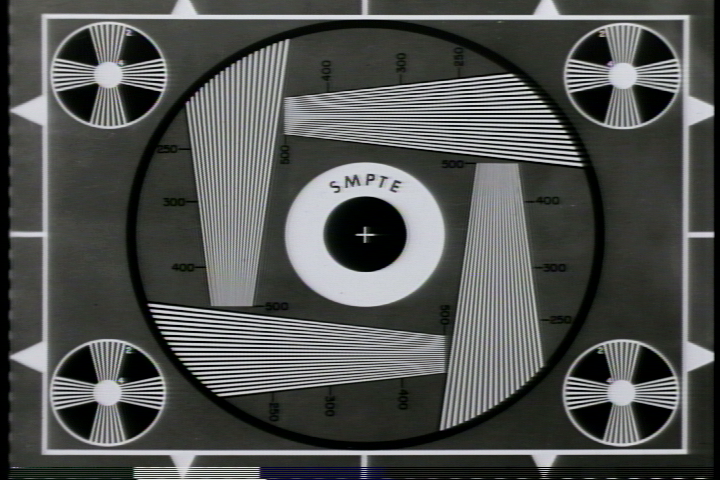

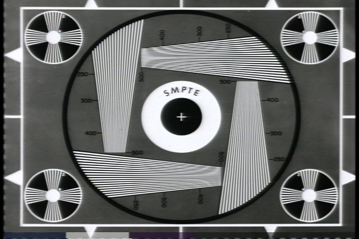

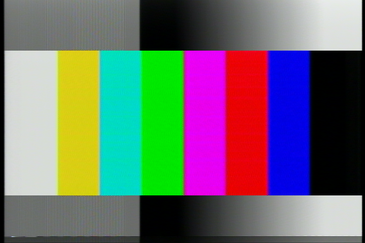

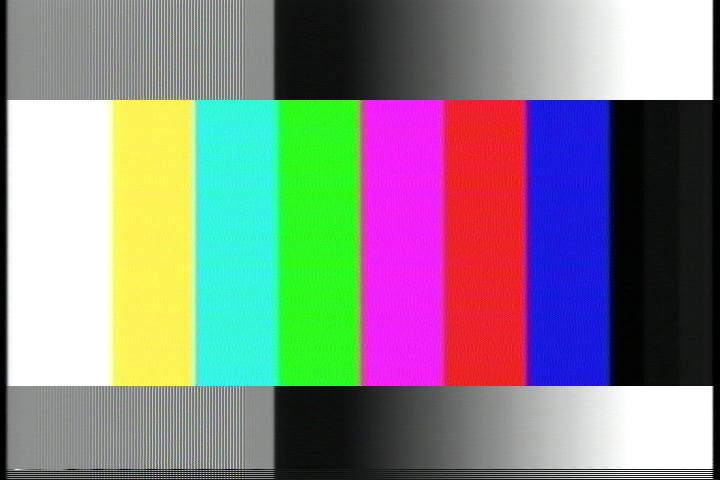

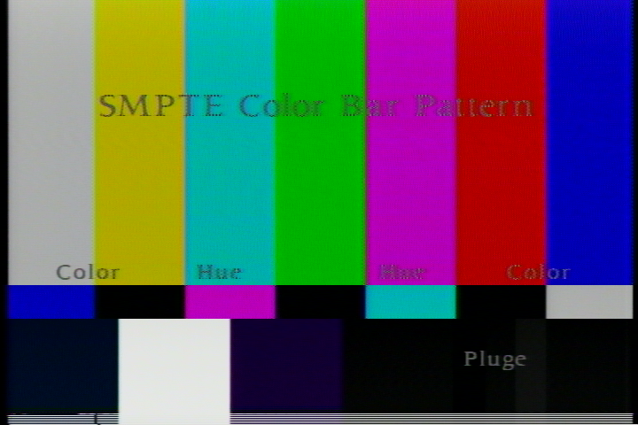

    The quality for the S-Video input seems fine. Here are some comparisons to the ATI 600 USB. The darker image each time is the "HD AV Grabber 2.0" -- this isn't the default but I had lowered the brightness to try to counter the blooming that I saw with the defaults, and the monitor I used wasn't calibrated.
    AVS Chapter 7 -> Pioneer LaserDisc player -> Composite cable -> Pioneer DMR-E20 -> S-Video input

ID:	16917Click image for larger version
ID:	16916Click image for larger version
ID:	16914Click image for larger version

    I've got it installed on another computer using eMPIA's own 2828x driver (this device is USB 28285). But I don't have video sources available at that location to see whether it works still.
    I totally forgot to mention that this thing has a fatal flaw: the captured audio always contains a high-pitched whine. Also, one of the brightness test patterns on A Video Standard caused some flickering and wiggling lines with this thing that wasn't an issue with the ATI 600.
