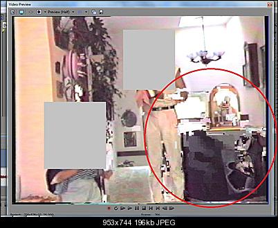

    i tried to convert an uncompressed video to compressed x264 avi video with this FFmpeg command:
    ffmpeg.exe -i test.avi -c:v libx264 -preset medium -crf 15 -c:a copy output_test.avi
    this was converted the video to what i want but there is a problem with dropped frames in sony vegas.
    it is happen only in vegas and i noticed that it is happen when there is a dropped frame..
    this is what happen:
    i know that it is happen on dropped frames because i tried to convert this also with the normal x264vfw encoder in VirtualDub.
    and i sow that this problem not happen but i see that there is a dropped frame/s..
    i don't know why it is happening...
    Please help me!
    Thanks for helpers!

  7. I do not have no problems with playing x264 compressed video in sony vegas.
    yes, It is true that I had a problem in the past
    https://forum.videohelp.com/threads/353739-Sony-Vegas-11-playing-very-slow-x264-videos-...44#post2223244
    And you did not help me .. You told me about the same thing - that i Need a powerful computer to play compressed x264 videos in sony vegas.
    But any way, I solved the problem.
    by uninstall Adobe Premiere and all my codec packs and install only the codec x264vfw.. after that sony vegas playes it perfectly Without the need for a strong computer.

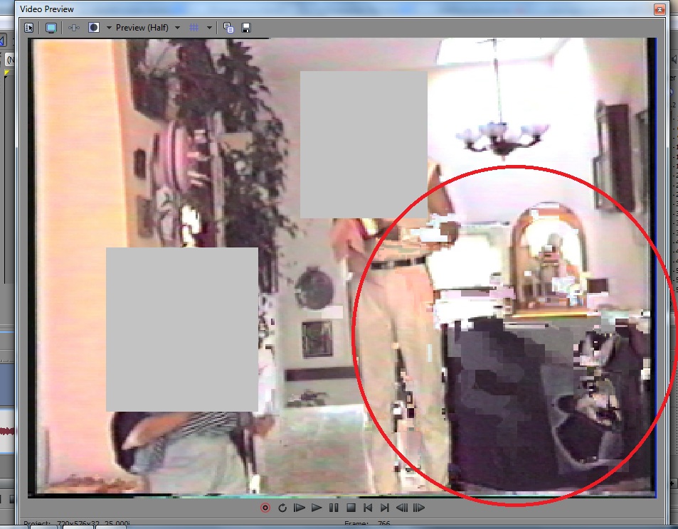

    and this is a drooped frame.
    I checked it in VirtualDub by frame by frame view..
    and i see the drooped frame even in the uncompressed video in sony vegas..
    so it is not because my computer is slow. it is because the reason that this is the video..
    and this problem I showed the picture in not because my computer is slow. it is because of the conversion.
    in is not happan with the x264vfw conversion(not by ffmpeg). when i use the x264vfw conversion, so the video play in sony vegas Exactly the same like the uncompressed video - Without stopping and with the drooped frame in the same time..
    i hope that now all is clear
