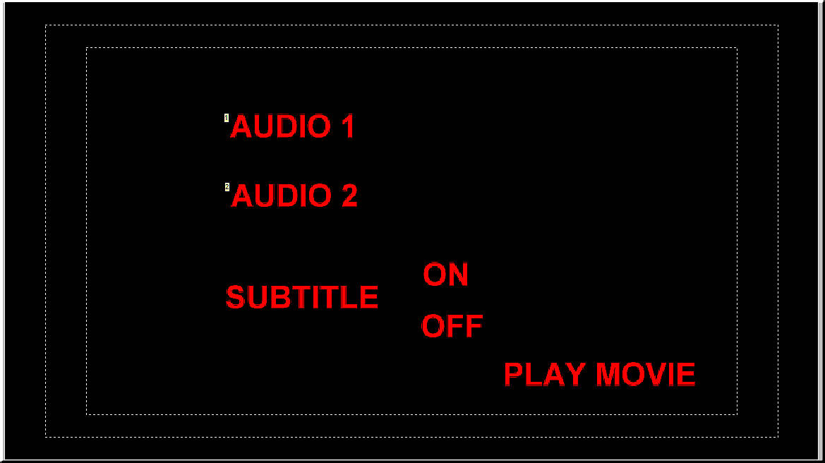

    I had some time so here are the instructions.
    You will need Root and 3 extra menus see connection picture.
    Root menu will have one button "play movie" linked to "Audio" menu.
    Audio menu will look like a picture "Audio"
    Once you make all text clone this 2x to SUB1 and SUB2
    Audio menu will have 2 buttons "Audio1", "Audio2" they will link to SUB1 and SUB 2 respectively.
    SUB menu All the buttons will have link
    Sub1 will have AUDIO1 linked to Audio1 of the movie ( Audio2 just text -no button),Subtitle "ON" button will be liked to Subtitle track of the movie "OFF" button will be linked to "Subtitle OFF"in subtitle drop down window.
    "Play Movie" button will link to "Play List 1"
    Second audio menu will be the same except "AUDIO2" will link to second audio track (AUDIO1-No button) and "PLAY" will link to Play List 2.
    When you do Audio and Sub link make sure that drop down window has "+Restart Menu" checked.
    There is other way, using Register, but this one is easy.
