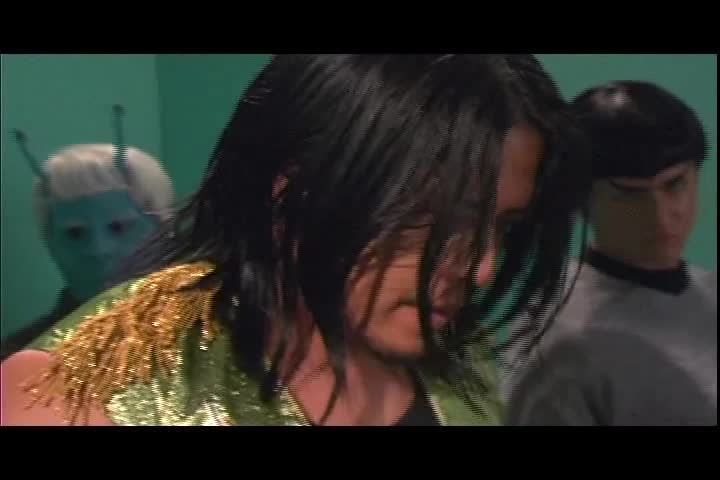

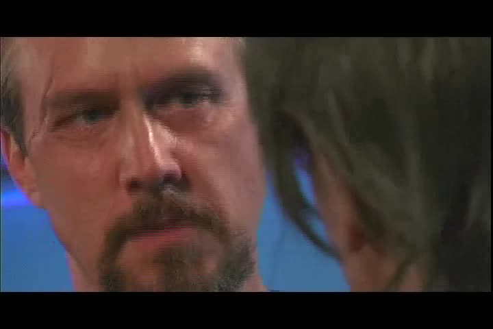

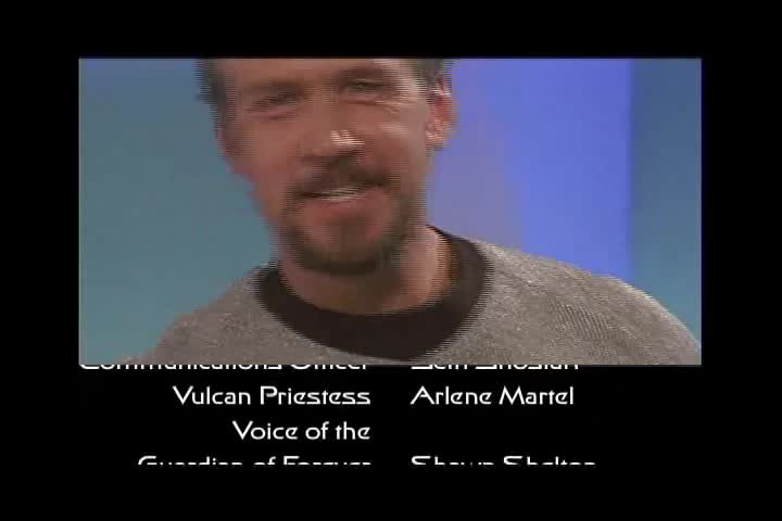

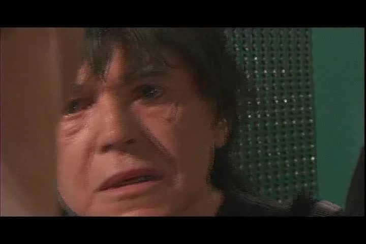

    i usually stay out of interlace discussions, i just throw away the file
    i would like like to know how IF possible
    to remove crap like this, ( fix it) when all you have is the converted file, flv, avi, mp4, wbem etc..
    how would you do a 'hard decimate' or what ever, avisynth and virtual dub ?
  10. Originally Posted by theewizard View Post
    If you mean 30p with a duplicate every 5 frames (like the sample in post 3): TDecimate()
    But that sample is (mostly) soft telecine. You were playing it with a deinterlacing player, maybe? I think theewizard must be referring to something else, maybe something he downloaded that wasn't handled correctly. There's nothing wrong with the sample.
  12. So you weren't referring to the sample in post 3? I didn't think so. However, screenshots tell us nothing. Samples please.

    the mp4 verson has the same problem, but is a lower resolution file
    the segmented mp4, does not have this problem, it has the video drop out problem, but is the one i ended up using as it was more pleasing to watch
    movie is 88 minutes
    i will make a couple of cut samples and post them
    i had to retrieve the video from the recycle bin just to make the snap shots
    these are single frame shots, that is the way those frames look
    thats why i just delete and start over with another source IF i can find it
