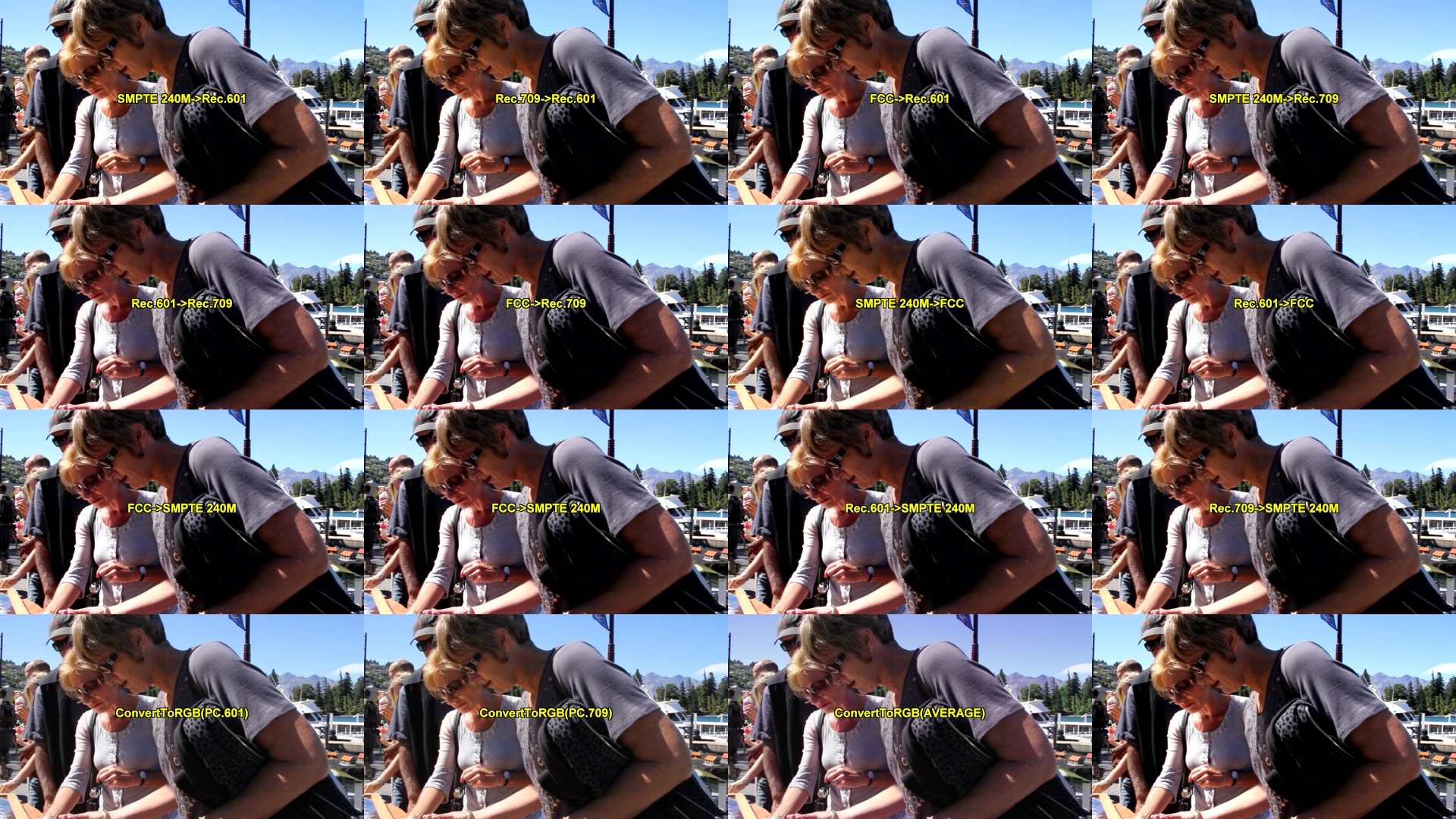

  4. for general amusement, I just made a small script to see the difference between the different ColorMatrix and ConvertToRGB calls in avisynth:
    LoadPlugin("G:\avisynthPlugins\ColorMatrix.dll")
    LoadPlugin("G:\avisynthPlugins\DGDecodeNV.dll")
    # loading source
    v = DGSource(dgi="H:\Temp\222519718mov_deb1536f480475f7d593219aa1afd74c_41.dgi",fieldop=0) # another source filter could be used
    v = v.trim(580,620)
    v = v.BicubicResize(v.width/4,v.height/4)
    a = v.ColorMatrix(mode="SMPTE 240M->Rec.601",clamp=3,interlaced=false).Subtitle("SMPTE 240M->Rec.601", align=5)
    b = v.ColorMatrix(mode="Rec.709->Rec.601",clamp=3,interlaced=false).Subtitle("Rec.709->Rec.601", align=5)
    c = v.ColorMatrix(mode="FCC->Rec.601",clamp=3,interlaced=false).Subtitle("FCC->Rec.601", align=5)
    d = v.ColorMatrix(mode="SMPTE 240M->Rec.709",clamp=3,interlaced=false).Subtitle("SMPTE 240M->Rec.709", align=5)
    e = v.ColorMatrix(mode="Rec.601->Rec.709",clamp=3,interlaced=false).Subtitle("Rec.601->Rec.709", align=5)
    f = v.ColorMatrix(mode="FCC->Rec.709",clamp=3,interlaced=false).Subtitle("FCC->Rec.709", align=5)
    g = v.ColorMatrix(mode="SMPTE 240M->FCC",clamp=3,interlaced=false).Subtitle("SMPTE 240M->FCC", align=5)
    h = v.ColorMatrix(mode="Rec.601->FCC",clamp=3,interlaced=false).Subtitle("Rec.601->FCC", align=5)
    i = v.ColorMatrix(mode="Rec.709->FCC",clamp=3,interlaced=false).Subtitle("Rec.709->FCC", align=5)
    j = v.ColorMatrix(mode="FCC->SMPTE 240M",clamp=3,interlaced=false).Subtitle("FCC->SMPTE 240M", align=5)
    k = v.ColorMatrix(mode="Rec.601->SMPTE 240M",clamp=3,interlaced=false).Subtitle("Rec.601->SMPTE 240M", align=5)
    l = v.ColorMatrix(mode="Rec.709->SMPTE 240M",clamp=3,interlaced=false).Subtitle("Rec.709->SMPTE 240M", align=5)
    m = v.ConvertToRGB("PC.601").ConvertToYv12().Subtitle("ConvertToRGB(PC.601)", align=5)
    n = v.ConvertToRGB("PC.709").ConvertToYv12().Subtitle("ConvertToRGB(PC.709)", align=5)
    o = v.ConvertToRGB("AVERAGE").ConvertToYv12().Subtitle("ConvertToRGB(AVERAGE)", align=5)
    p = StackHorizontal(a, StackHorizontal(b, StackHorizontal(c, d)))
    q = StackHorizontal(e, StackHorizontal(f, StackHorizontal(g, h)))
    r = StackHorizontal(j, StackHorizontal(j, StackHorizontal(k, l)))
    s = StackHorizontal(m, StackHorizontal(n, StackHorizontal(o, v)))
    StackVertical(p, StackVertical(q, StackVertical(r,s)))
    I also made a screenshot of the result and attached it.
  5. I'm pretty sure PC.709 is the correct conversion.
  6. Yup, only thing that surprised me: shouldn't one of the ColorMatrix conversion also produce the correct conversion?

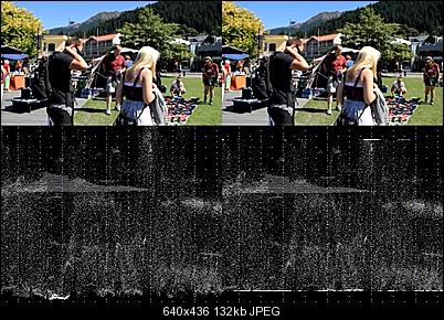

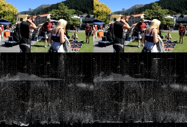

  7. Originally Posted by Selur View Post
    No. Because the none of the ColorMatrix conversions compresses the luma levels from 0-255 to 16-235. And you set clamp=3 so the source was clamped* to 16-235 before (and after) conversion, losing all the super darks and super brights. Before (left) and after (right) ColorMatrix(mode="Rec.709->Rec.601",clamp=3):
    Notice how the top and bottoms of the graph are truncated on the right. But everything in the middle is the same.
    Finally, whatever software you used to to convert YUV to RGB for display assumed normal 16-235 levels and stretched them to RGB 0-255. So even if you had used clamp=0 that final conversion to RGB would have crushed the super darks and super brights.
    * Clamped may not be a good word to describe what's going on. Truncated or squashed is probably more accurate. All values below 16 become 16. All values above 235 become 235.
