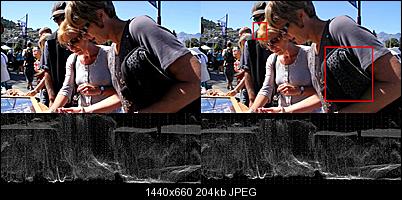

  20. Well, I'll be! I just tested Handbrake with the sample from the above vimeo.com link and indeed it "legalized" the luma levels to standard rec.709. This would explain why you are seeing the washed out video. But notice how you can see more detail in the darks and brights in the converted image, they aren't blown out. Original on the left, handbrake encoded on the right (I downscaled the 1080p sources for these snapshots):
    Does this mean Handbrake is automatically converting xvYCC to rec.709?

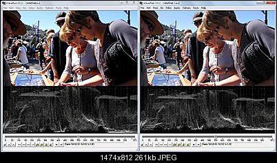

  24. I reencoded the T2i sample video (opened with ffVideoSource() in AviSynth) with x264 CLI, making an MKV file. The MKV video retained the same full range luma. I then converted that file with Handbrake. The Handbrake encoded file retained the full range luma. I repeated the experiment using an x264 encoded MP4 file instead of MKV. Handbrake kept the full range luma again.
    So it appears there's something in the original MP4 file that flags the video as full-range. Apparently Handbrake sees that flag and reduces the range to standard rec.709 when it converts.

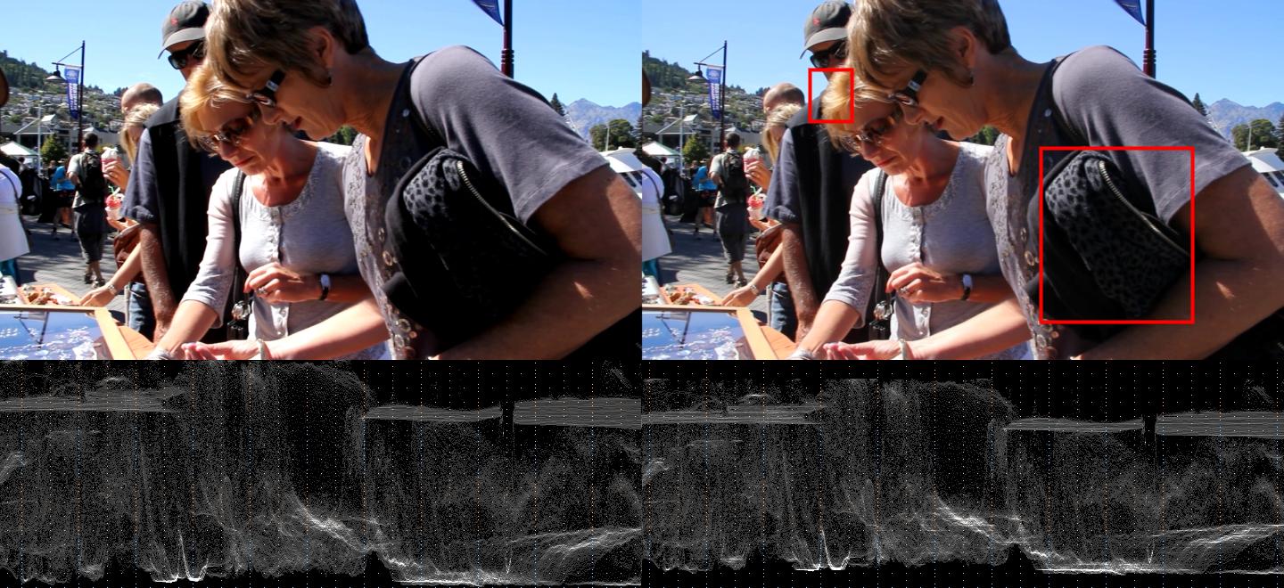

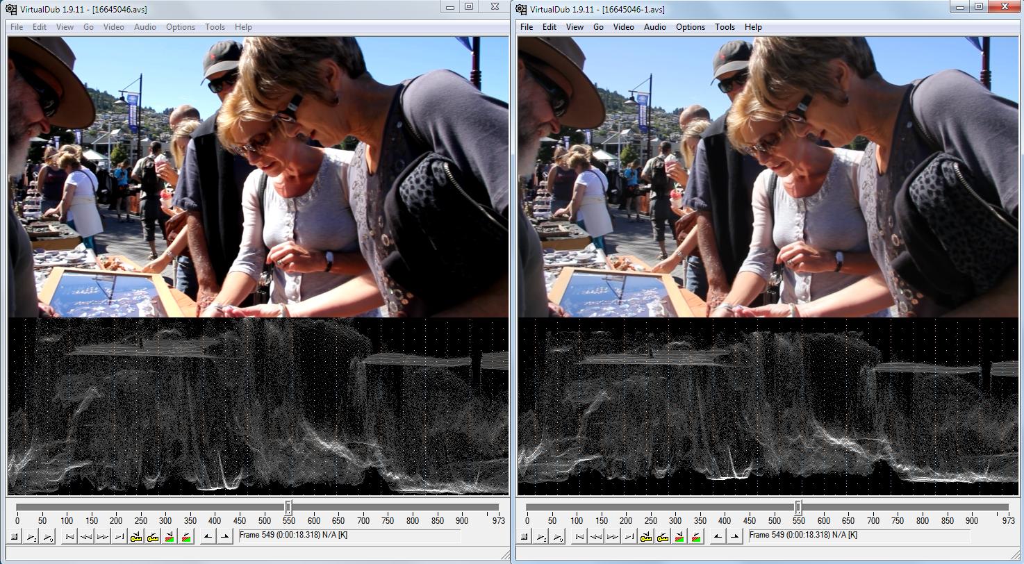

  27. XMediaRecode did the same contrast reduction as Handbrake. An older version of Xvid4PSP (5.0.37.8) kept the full range luma. But that may end up causing a problem with playback. If your player sees the full range flag in the original video and compensates during playback, it won't see such a flag in the Xvid4PSP converted video -- the blacks and brights will be crushed. What do you see when you play the original video? At about 19 seconds into the video:
    On the left you can see that the pattern in the dark jacket has disappeared. The highlights in the woman's hair are blown out. If your player is compensating for the full scale luma you will see something like the image on the right. But after conversion you may see something like the image on the left.
