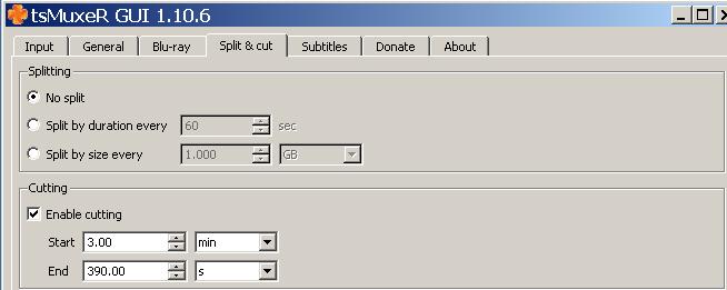

Thx man, this is a good software and does what I want but have some issues:
1] The output file (the scene clip tht I want)... has boxes & lags if FF/REV in any player.
2] The output file is not in an .mkv container like the original content.
Is there any way to solve the above issues. -

1. I just tested using MPC-HC and, while I have no idea what you mean by 'has boxes', it does FF fine. I don't see any way to reverse, only skip back in MPC-HC.
2. That's right, no MKV. I use it to make M2TS files for a Playstation3. It's just remuxing and not reencoding anything so it shouldn't really make any difference what container it's in, as long as your player can play it, and there are several choices on the main page. The M2TS container is pretty universal, more so than MKV I think (the PS3 won't touch an MKV).
You might try davexnet's suggestion if you absolutely have to have an MKV. -
