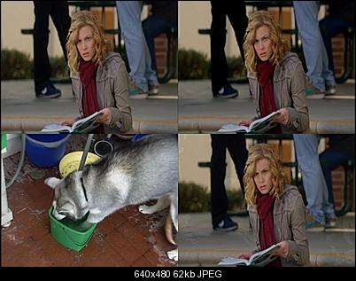

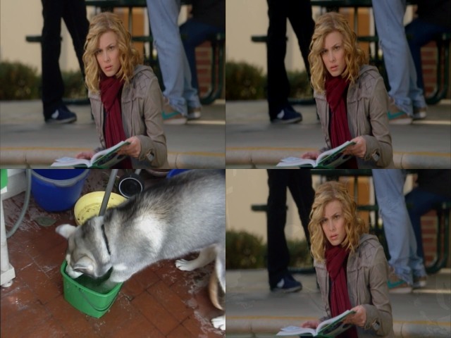

    If your capture card inserted a frame to replace a dropped frame a median filter should still recover the correct frame pretty well. Say, you have frame 1000 in two caps but the third cap has a copy of frame 999 instead (for some reason frame 1000 was missed and a second copy of frame 999 was substituted). A median filter should still give pretty good results. You might get some pixels from frame 999 but only in the case where that pixel falls between the values of the pixels in the other two caps. So even if it's technically from the wrong frame it's similar to the pixels from the correct frames.
    Here's an example. I don't have 3 VHS caps right now so I used two videos. In the top left corner is one of the videos. In the top right is the same video, just darker to simulate a second capture that's a little different. In the bottom left is a completely different video. In the bottom right is the median of those three videos:
    So even with a completely unrelated third video the median filter gives pretty good results. With a substituted prior frame you should get even better results.

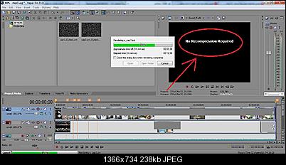

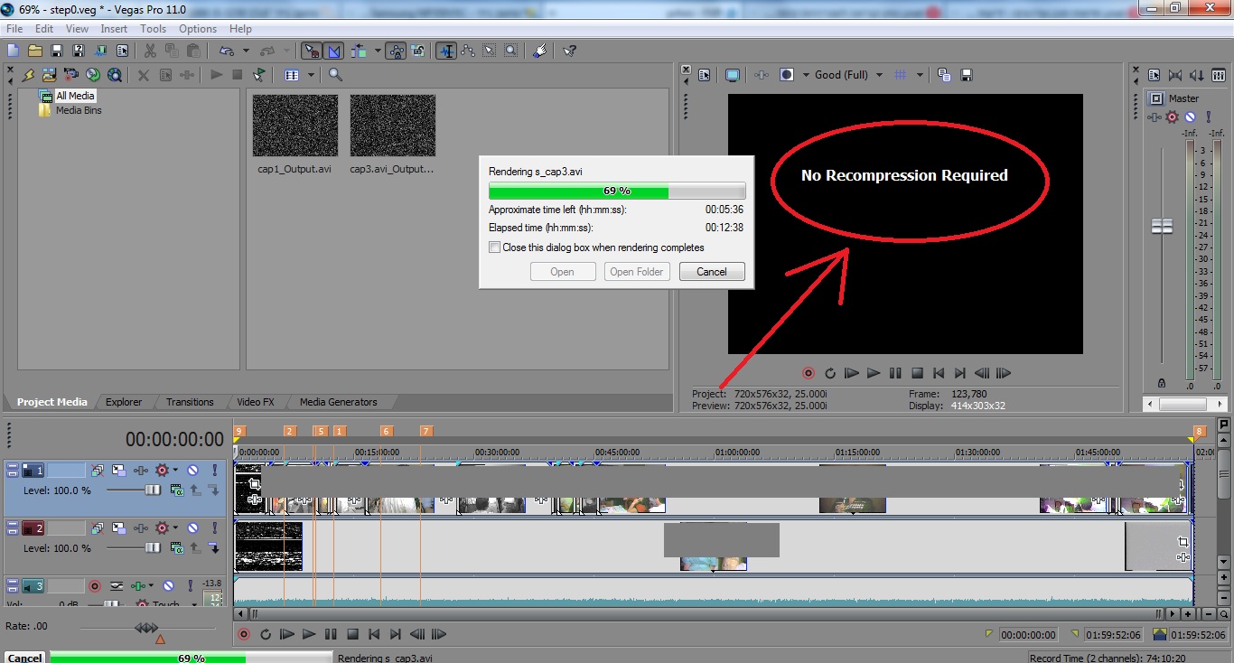

  8. i just wanted to share useful information about sony vegas.
    I always compresses my caps the x264 encoder.
    When I do the syncing repair, then sony vegas does not compress the video again.
    So there is no disadvantage with syncing in sony vegas
