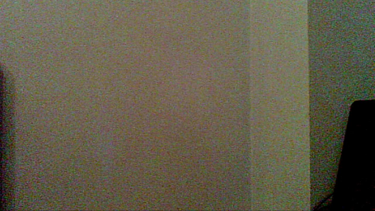

  13. Upload more samples? The sample in your first post is fine here -- I think. It's very grainy but looks to be a shot of some walls with part of a chair at the edge of the frame. The audio is just background noise with a constant whine and a few clicks. The codec is MJEG.

    VLC had no problems playing it.

    Mar 2013
    [Attachment 17026 - Click to enlarge]
    Yes, that first video was fine I know. The grains were just the quality of the camera.

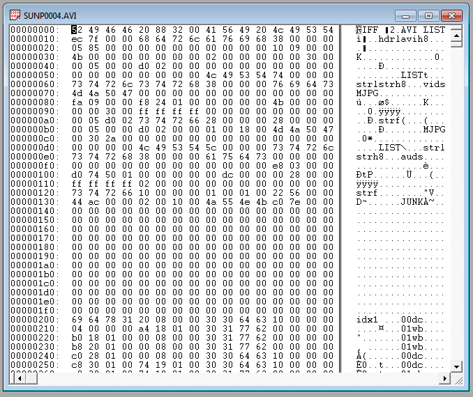

  15. Use a hex editor to trim out the first 10 million bytes or so. Then post that. Actually, just open the file with a hex editor and show what the first page of data looks like. That will include the AVI and stream headers. Enough to give some hints. If that looks OK you can go on to uploading a sample. Here's a hex dump of your original AVI file:

    Notice it starts with RIFF (in the right part of the dump). All AVI files must start that way. You can see the MJPG tokens several lines below that indicating the video codec. Also included in there are the frame dimensions, number of frames, etc.
    There are many free hex editors available on the net. VirtualDub has a built in hex editor you can use. Start the program then select Tools -> Hex Editor. In the Hex editor select File -> Open...

    Mar 2013
    By the way, one common problem with memory cards is that unscrupulous sellers take small cards and format them to look like bigger cards, then sell them at the price of the bigger card. For example, they may take a 4 GB card and format it as if its an 8 GB card. The card will appear to be working fine until you write more the 4 GB to it, then files start getting corrupt (not just new files, even files written earlier). I would try a different card. One bought from a reputable seller.
    I'll try the hex thing now.

    EDIT:
    Results from hex editor...No RIFF, so that's a start, then it's all just what seems like random characters...
  17. Originally Posted by FraserDAHD View Post
    The card is a legitimate Kingston one so there's no problems there.
    A brand name is no guarantee. Where you got is is more important. Anyone can buy a bunch of 4 GB Kingston memory cards, reformat them, then sell them on ebay, craigslist, at the local swap meet, etc. A malfunctioning card could also be the problem. So regardless of where you got it, try a different card for future recordings.
    EDIT:
    Yes, the AVI header has been overwritten with junk. It may still be possible to restore some of the video (if it hasn't all been overwritten) but it gets much harder. The process involves copying the header data from a good file (from the same camera, with similar resolution, length, etc.) onto the bad file (obviously, make a backup of the file since you may screw it up even more). Then try some AVI fix utilities. Such utilities will search through the data in the file looking for video and audio chunks. Fortunately for you, MJPG encodes each frame as a complete image making recovery easier. VirtualDub has some ability to fix AVI files.
