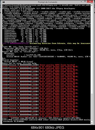

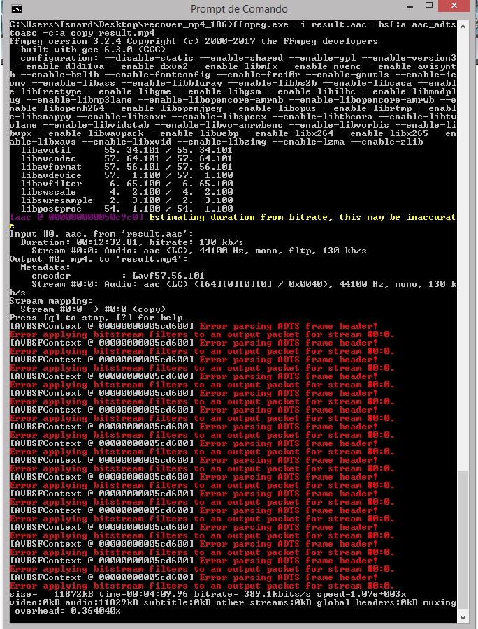

  7. Hi! I am having almost the same problem: got a m4a file that is corrupted and I got some progress using recover_mp4 program http://slydiman.me/eng/mmedia/recover_mp4.htm, but I got some errors in the last step, when I have to use FFMPEG. Could someone please help me with it?Click image for larger version
    Thanks in advance!
