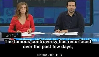

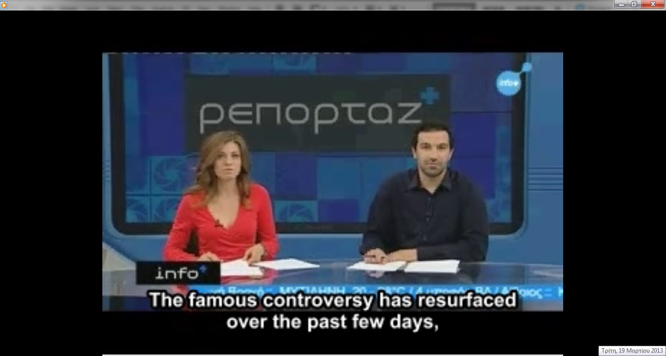

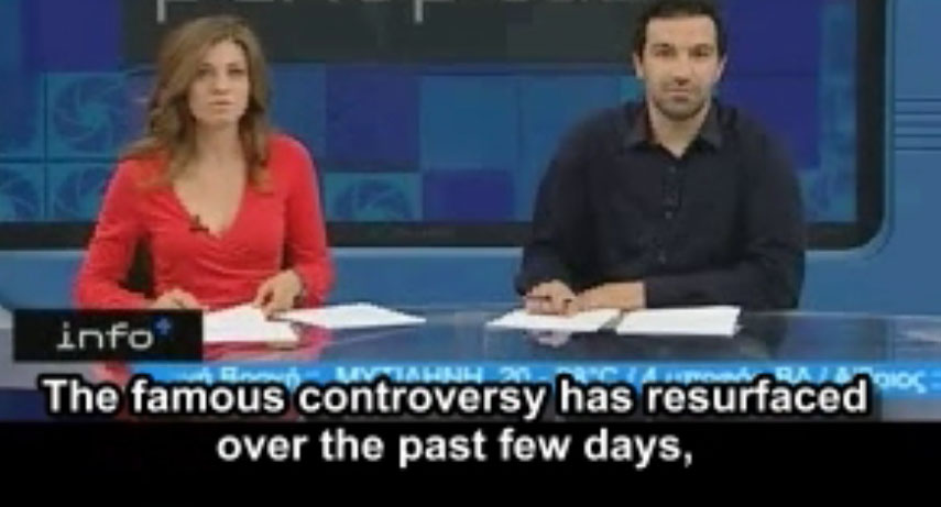

    Here is a screenshot:
    This is for a paid work assignment and I need to make the subtitles as sharp and clear as possible. I am trying to find a solution as this subtitle quality is unacceptable.
