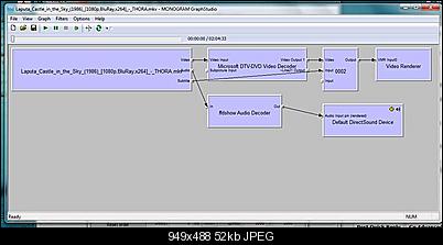

    I'm having a problem with subtitles. I have a downloaded mkv file and when I play using VLC the default is Japanese audio and English subtitles. I can use the options and select an English audio track and select a number of different language subtitles or disable subtitles. (The audo and subtitle files do not appear to be separate files as I only have the one mkv file.) Thus I can play the mkv video with an English audio and no subtitles, which is what I want.
    The problem is when I use AVStoDVD to convert to DVD, I choose the English audio instead of the Japanese. Next a window opens up for the various language subtitles and I don't select any of them. The result is my converted video that plays the English audio but has hard coded English subtitles on top of it. The media player does not recognize the subtitles so I can't turn them off. How does the English subtitles get in there during the conversion and how can I stop this from happening? I know they are not hard coded to begin with as I can turn them off when I play the mkv file with VLC media player.
    I tried opening the Title Edit window and select the subtitles tab before the conversion but it says there are no subtitles.

    how can I turn this off so the subtitles are not included?

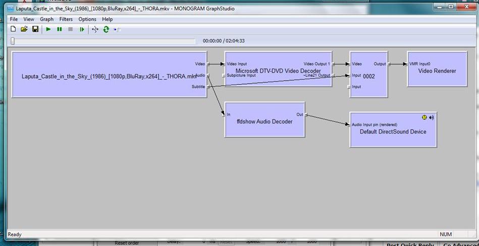

    here is a screen shot of the filter graph

    The box in the image above 0002 appears to be the subtitle filter.
    Have you installed one of the items I mentioned? Usually right clicking on it and selecting properties
    will tell you what it is.

    the subtitles don't seem to be a separate file. there are two other files that came in the download, one is a .md5 file and the other is .nfo which says it is system information.
    It appears to be vsfilter. I didn't intentionally install this but it may have come as an add on with something else. It doesn't appear in my computers list of installed programs.
