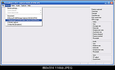

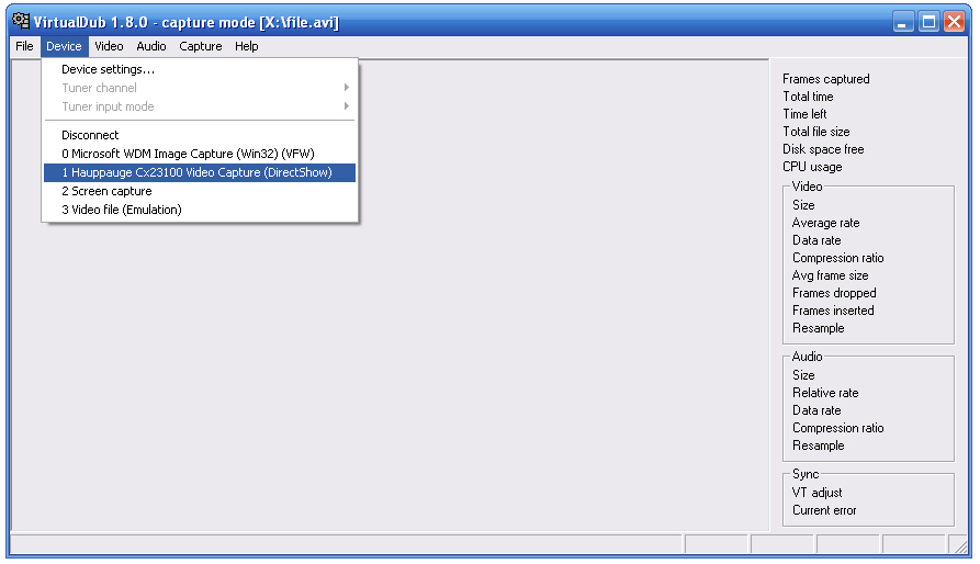

  14. Member PuzZLeR's Avatar
    Oct 2006
    Toronto Canada
    I've been experimenting the past few days capturing with DScaler. I remember seeing a comment once where someone said to NEVER capture with DScaler and I gotta say:
    Unlike VDub, DScaler instantly recognizes my Hauppauge USB-Live2 device, there have been ZERO dropped frames and the audio is in perfect sync.
    What am I missing here?
    Hi,
    The Hauppauge USB-Live2 works perfectly with VirtualDub, which recognizes it for me.
    It also can produce the purist's YUY2 AVI output. Not sure if it just upsamples 4:2:0 MPEG to 4:2:2 AVI, or it's legit YUV 4:2:2 video that the Conexant series chip under the hood is capable of handling, but I would certainly bet using straight RGB is alot of upsampling fluff. At any rate, it works just fine, also with zero dropped/inserted frames and perfect sync.
    However, I'm in NTSC-land, so not sure how it fares for PAL.
