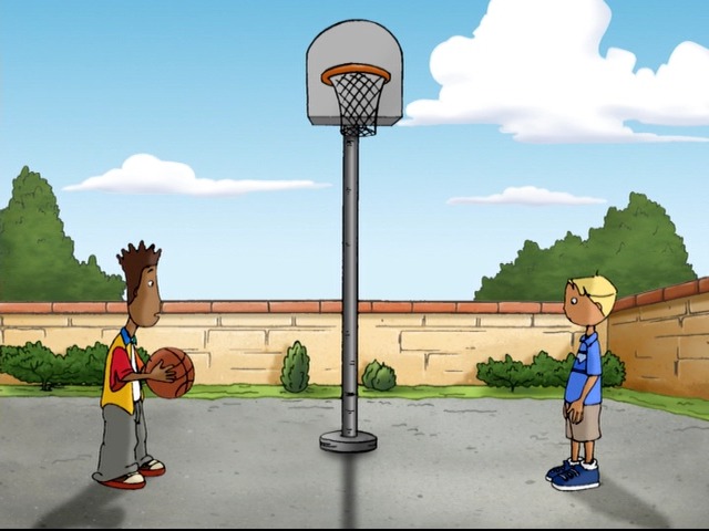

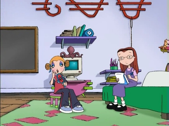

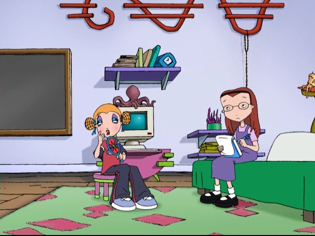

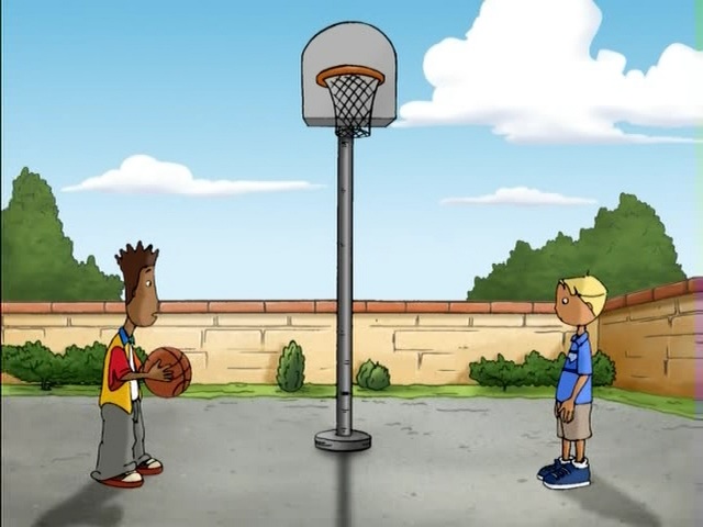

    On the subject of green and magenta lines along the right edge, I have seen a similar artifact on a DVB-S channel. It's not just a color artifact like for your tapes though. Comparing to the DVD, it looks like the discolored content is just the right-most pixel(s) stretched out rather than real picture content.
    [Attachment 17135 - Click to enlarge]
    [Attachment 17137 - Click to enlarge]
    [Attachment 17138 - Click to enlarge]
    [Attachment 17136 - Click to enlarge]
  3. Interesting. This is just a guess, but can this be happening during the analog->digital conversion process, I wonder. (Perhaps when some analog levels are not within correct limits?) Like I said, I may be wrong though. It is just a guess.
  4. Formerly 'vaporeon800' Brad's Avatar
    Apr 2001
    Vancouver, Canada
    Just to be clear, there was no analog involved on my end in recording the DVB-S stream. Of course I don't know what manipulations were performed before that point, but the colors, levels, and detail don't appear to deviate very far from the DVD.

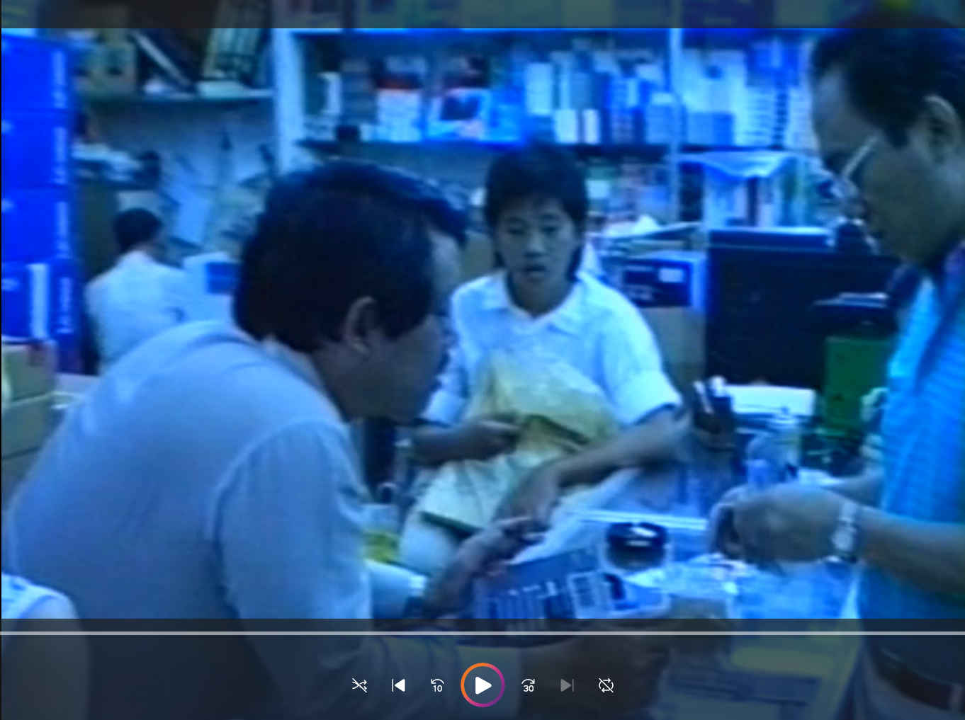

    This may be totally irrelevant for you by now, still... if anyone is still listening:
    I have the same problem. I mean not _similar_ but totally identical to yours. Same width, same characteristics of the discolored part. See attached screenshots.
    I have used two D8 camcorders (TRV345E and TRV480E PAL cameras) and both do the same. Both cameras in almost mint condition.
    Playing the tapes on an analog device is perfect, edge to edge.
    For me this looks like a system wide error on Sony side. I wonder whether it affects pro level D8 decks when playing analog tapes (if they exist at all).
    Right now, my only choice seems to use the D8 camera as a digitizer and use an external analog player as signal source. And re-capture hundreds of hours to get rid if 15 pixels worth wrong colors. I'm not sure I want this.

  26. Originally Posted by shepherd View Post
    This is unfortunately still relevant to me, as, like you, I ended up capturing about 30 Video8 tapes via DV out on a DCR-TRV240E I got just for this purpose and haven't gotten around to process them all yet. It's the same conclusion that everyone else reached: this seems like a design flaw on all Sony Digital8 camcorders that can play Video8/Hi8. It most likely got past their quality control since it's PAL only, not NTSC, and the issue is invisible on the viewfinder / TVs of the time.
    I don't have anything that can play Video 8 natively anymore (I did find copies of all the Video8 tapes in MiniDV tapes afterwards but as I'm unsure of how the transfer was done – I'd have to check whether it's worth using those over the original Video8 tapes), so I ended up going the post-processing route. I can share the vapoursynth script I wrote to process these captures:
    import vapoursynth as vs
    import havsfunc as haf
    import adjust
    core = vs.get_core()
    core.std.LoadPlugin(path="/usr/local/lib/libmvtools.dylib")
    clip = core.ffms2.Source(source=file)
    ## a) Crop extra pixels included in DV format
    # https://web.archive.org/web/20191026141308/https://bjohas.de/wiki/Tutorials/Video/Pixel_Aspect_Ratio
    # https://web.archive.org/web/20050404092907/http://www.bbc.co.uk/commissioning/branding/picturesize.shtml
    clip = core.std.Crop(clip, 6, 12, 0, 0)
    ## b) Correct the broken V channel at the edge coming from the D8 camera in the Video8 -> DV conversion
    # https://forum.videohelp.com/threads/354425-Hi8-capture-using-Digital8-camcorder-Edge-color-issues
    badPixels = 20/2
    y = core.std.ShufflePlanes(clips=clip, planes=0 , colorfamily=vs.GRAY)
    u = core.std.ShufflePlanes(clips=clip, planes=1 , colorfamily=vs.GRAY)
    vorig = core.std.ShufflePlanes(clips=clip, planes=2 ,colorfamily=vs.GRAY)
    v = vorig
    v = core.std.Crop(v, 0, badPixels, 0, 0)
    # Method 1 - inverting V and magnifying - didn't manage to get this to work
    #extra = core.std.CropAbs(vorig, badPixels, vorig.height, vorig.width-badPixels).std.Invert()
    #extra = adjust.Tweak(extra, cont=1)
    #extra = core.std.Levels(extra, min_in=0, max_in=200, min_out=0, max_out=255)
    # Method 2 - Reflecting V channel to the right
    #extra = core.std.FlipHorizontal(v).std.CropAbs(badPixels, v.height)
    # Method 3 - Stretch V channel to the right
    extra= core.std.CropAbs(v, 2, v.height, v.width-2).resize.Point(badPixels, v.height)
    v = core.std.StackHorizontal([v, extra])
    clip = core.std.ShufflePlanes(clips=[y, u, v], planes=[0, 0, 0], colorfamily=vs.YUV)
    ## c) Deinterlace
    clip = haf.QTGMC(clip, Preset='Slower', TFF=True)
    ## d) Resize to square pixels
    clip = core.resize.Bicubic(clip, 768, clip.height)
    ## e) Mask head switching - disabled
    # https://bavc.github.io/avaa/artifacts/head_switching_noise.html
    #bottomPixels = 10
    #clip = core.std.Crop(clip, 0, 0, 0, bottomPixels).std.AddBorders(0, 0, 0, bottomPixels, color=[0, 128, 128])
    clip.set_output()
    And the bash script to output H.264/AAC MP4s suitable for playing on an average device from the input above, just for completion's sake.
    #!/bin/bash
    ARG="$1"
    FILENAME="${ARG##*/}"
    NEW_VIDEO="${FILENAME%.*}.mp4"
    /usr/local/bin/vspipe -a "file=$ARG" --y4m -p ~/transcode_video8.vpy - | ffmpeg -i - -i "$ARG" -map 0:v -map 1:a -c:v libx264 -preset slow -crf 18 -c:a libfdk_aac -vbr 5 "$NEW_VIDEO"
    It does a bit more, namely deinterlacing and square pixel resampling. Relevant part is under b), but the values there assume you previously cropped the extra black pixels from step a) – adjust accordingly.
    I attempted three methods as you can see: I wasn't able to get jagabo's suggestion of playing with inverting the V channel working (suggestions welcome!). Reflecting the V channel to the right was too distracting to the eye. I found stretching the V channel the least bad – it's only really noticeable if you get something like the edge of a red object poking through the right.
    Any feedback or suggestions are welcome.
