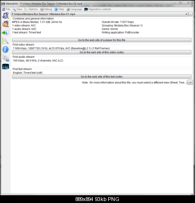

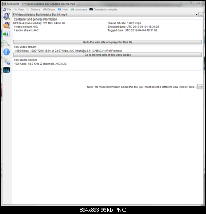

  8. En Taro Lawllmaster lawllmaster's Avatar
    Mar 2013
    The U.S. of A
    I did not upscale, and here's what MediaInfo says:
ID:	16760Click image for larger version
    The 1st pic is the source, the 2nd pic is the output. You can clearly see the bitrate has skyrocketed... Maybe this is the problem? But it's funny, cuz I didn't change anything (frame size, fps, audio quality, etc) :/
  9. Yes that's the problem
    filesize = bitrate * running time
