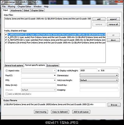

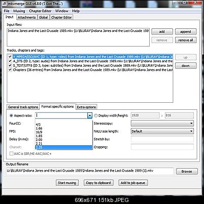

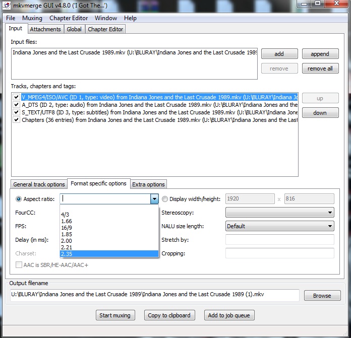

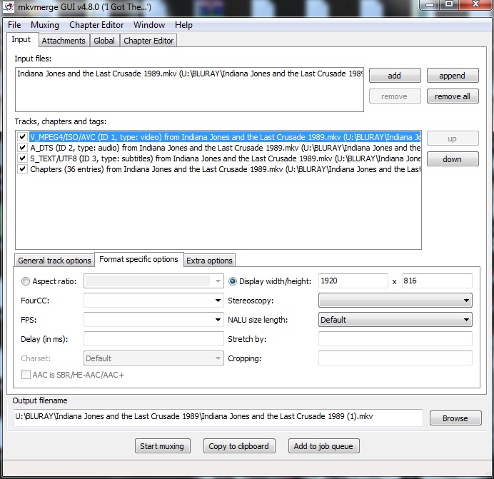

    When I have that problem, I will run them through mkvmerge GUI and manually set the aspect ratio.
    It takes a few minutes to process but it is not re-encoding anything, just rewriting the header info.
    No need to add black borders or re-encode.

    Noahtuck...your suggestion worked perfectly! Thank you so much!!! And you too poisondeathray for providing a backup plan! Gotta love the power of the internet (and helpful posters) to solve your problems!!!
