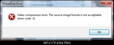

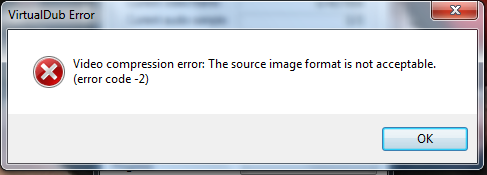

    but i get this error with the DIVIX codec:
    and i want to resize in VirtualDubMod but keep the original ratio..
  4. I suspect you have an illegal frame size. I think Divx requires at least mod 2, maybe mod 4.

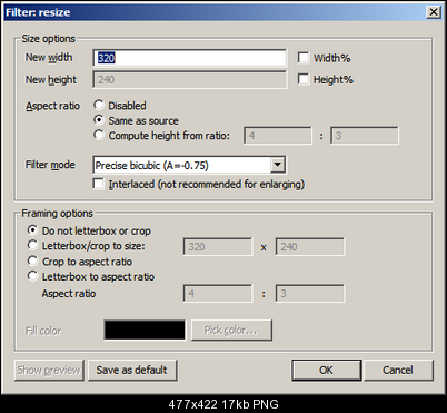

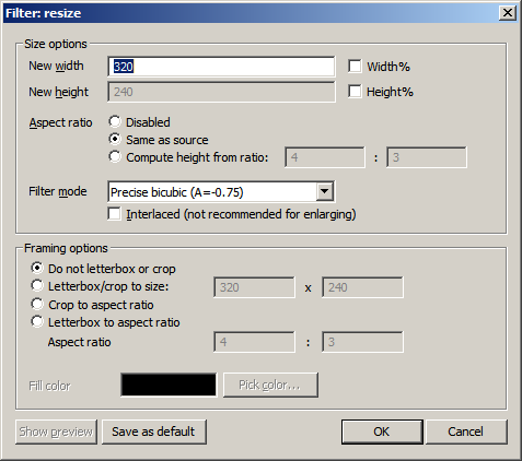

  5. i am looking for this filter:
    because the option to keep the ratio..
    i didn't found download for it..
    can you help me?
  6. That screenshot is from vdub's resize filter
  7. You don't need to download the filter. It's built into VirtualDub. But be careful, keeping the aspect ratio may end up with an illegal frame size for Divx.
