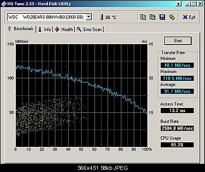

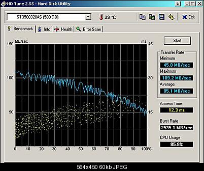

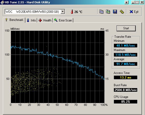

    Have a look at this. The first is an old Seagate 500GB 7200rpm drive. The second is a 2TB WD Green drive. I don't quite get the "slow" thing, unless your drives are running in USB2 enclosures. Ignore the CPU usage part. The PC was busy converting a video.... using a different drive or course. Also ignore the burst rate, that's not the drive, it's the SATA controller.
    Naturally a new 7200rpm large capacity drive will be even faster.

    And look at it this way..... if you short stroke the 2TB drive by just using a single 500GB partition and ignoring the rest, the speed difference increases substantially. The 500GB drive manages 110MB/s at the beginning, but by the end it's only doing 50MB/s.
    Now look at the first 500GB of the 2TB drive. It's also transferring at a rate of around 110MB/s at the beginning, but at the 500GB mark it's still doing over 100MB/s. And seek times for the 500GB partition would also be much lower than the average seek time for the 500GB drive, especially if they both rotate at the same speed. And of course you still have 1.5GB of extra space to use for storage

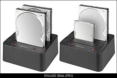

  19. SixFiftyThree,
    XP does support AHCI and all the goodies which go with it such as hot-swapping and port multiplying. The issue is whether a particular controller supports it. I've got three different SATA controllers in this PC. Intel, JMicron and Silicon Image. Only the JMicron supports port multiplying and it works (I'm running XP). Newer Intel controllers may support it, although if they do I'm not aware of it. I'm fairly sure Silicon Image have a chipset or two which do. Pretty much all SATA controllers support hot swapping these days.
    If the MB has an Intel chipset you may need a PCI-e SATA card to give you an extra couple of SATA ports which support port multiplying, but for me, USB3 has generally made eSATA obsolete. I don't use caddies, just USB or eSATA drive docks. Something like this:

    I've no doubt a single hard drive can keep up with most video capturing/editing requirements, but the issue might be.... can it keep up and do other things at the same time? So then you dedicate one drive to this job, another to that job, and what you end up with is a bunch of single drives running at single drive speed. Why not at least combine a couple of them for double the speed of a single drive?

  21. hello_hello, I appreciate your reply. Aside from having the right controller though, you still need the AHCI driver which isn't native to XP. It's what people have trouble with, resorting to modded installations ie. slipstreaming. There's no generic AHCI driver like newer Windows have. So I've read at least, my knowledge is a bit lacking here. Since you're running XP, I presume you had no problems like this.
    Anyway, I was looking at a USB 3.0 dock like that as well, just as another option. I like the caddy better since I prefer not to have exposed drives. But suppose I take the USB 3.0 route instead, I assume that hot-swapping, and multi-bay enclosures, should be a simple affair? I'll research it myself but all insight is helpful.
    Assuming SATA works as it should and the SATA chipset supports port multiplying (I don't think the many of them do) then it's probably no different to using USB3 in many respects. I've had some odd eSATA issues though, such as only being able to hot swap drives a few times before the PC stops recognising a newly connected device and I have to reboot, but maybe that's just the SATA chipset in this PC. USB3 just works, and swapping drives is just a matter of turning off the power switch on the USB dock first.
    I do find the eSATA cables annoying myself, but it probably wouldn't be so much of an issue using caddies, however you can't plug your SATA device into your TV to use it's media player to watch video. I can plug a USB dual drive dock into my TV/Bluray player and they'll happily read/play the contents of both drives.
