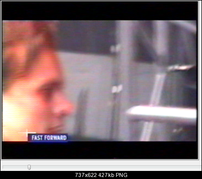

    The first you gonna see it on the screenshot. The second is about the frame rate if i dont wrong.
    Please tell me what avisynth filters to use because never clean VHS rip before.
    The second problem is - it seems that the picture jumping, im not sure if are drop frames or something but its very visible in some moments. its like the scenes switching to fast...

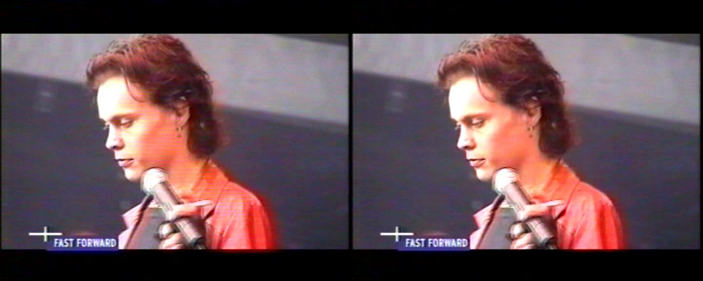

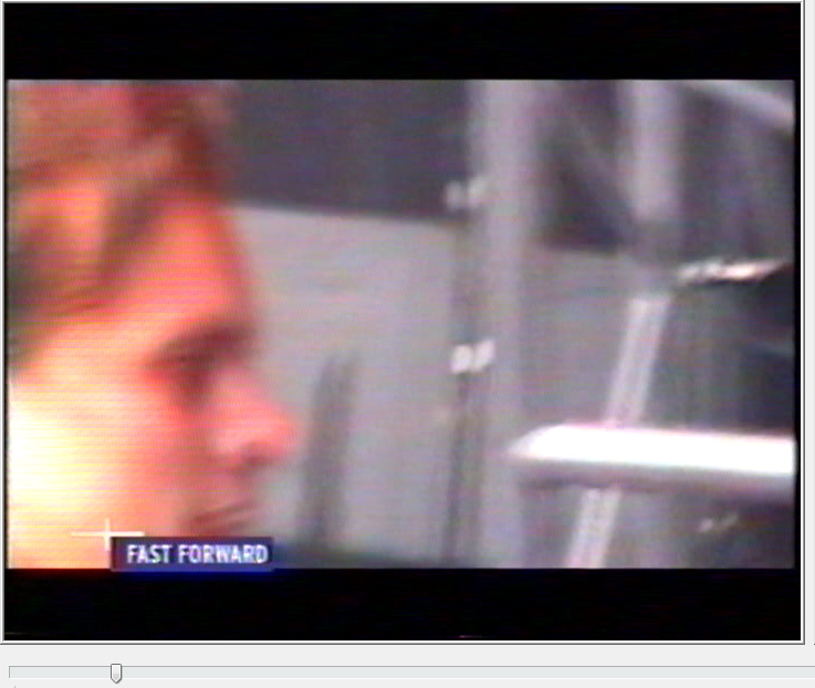

  11. If you don't have anything better than that you can start with this to get rid of the horizontal lines in the chroma:
    chroma=BicubicResize(720,288).BicubicResize(720,576).awarpsharp2(depth=30).ChromaShift(c=-6)
    MergeChroma(last, chroma)
    Before, after:
    It needs a lot more work but there's no point in pursuing this if you have something closer to the original.
    Before, after:
    [Attachment 16712 - Click to enlarge]
