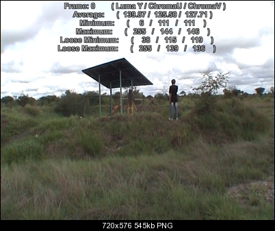

    Looking into luma correction a little more closely, it seems my camera's luma occupies the whole [0,255] range
Name:	original analysed.png

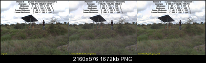

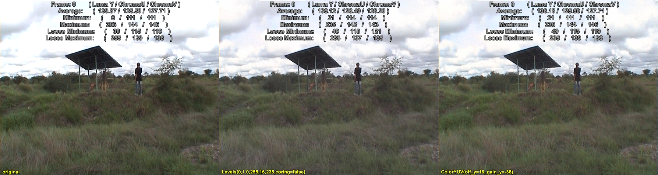

    So I experimented with mapping [0,255] to [16,235] in Levels(), and for comparison also included the corresponding ColorYUV() statement
    levels      = "Levels(0,1.0,255,16,235,coring=false)"
    coloryuv    = "ColorYUV(off_y=16, gain_y=-36)"
    StackHorizontal(ColorYUV(analyze=true).Subtitle("original", align=1), \
                    Eval(levels).ColorYUV(analyze=true).Subtitle(levels, align=1), \
                    Eval(coloryuv).ColorYUV(analyze=true).Subtitle(coloryuv, align=1))
    I'd previously imagined that Levels() compresses chroma also, but now mapping to [16,235] makes that fairly clear
Name:	original vs levels vs coloryuv.png
    The AVS 2.58 documentation for Levels() seems to confirm that
    For adjusting brightness or contrast it is better to use Tweak or ColorYUV, because Levels  also changes the chroma of the clip.
    Mapping [0,255]->[16,235] instead of [16,255]->[~16,235] as before certainly compresses luma more, but I haven't been able to spot any visible banding with this footage. ColorYUV() does a nice job of leaving chroma alone and the results are quite pleasing visually under the circumstances, so I think I'll go with that.

  3. Originally Posted by fvisagie View Post
    The few pixels down below Y=16 are only noise and overshoots. That's the reason why footroom and headroom are part of the spec. (Add Blur(1.0) before the levels check and you'll see all the pixels below 16 disappear.) Look at a mix of light and dark shots. And see if there is anything significant down there.

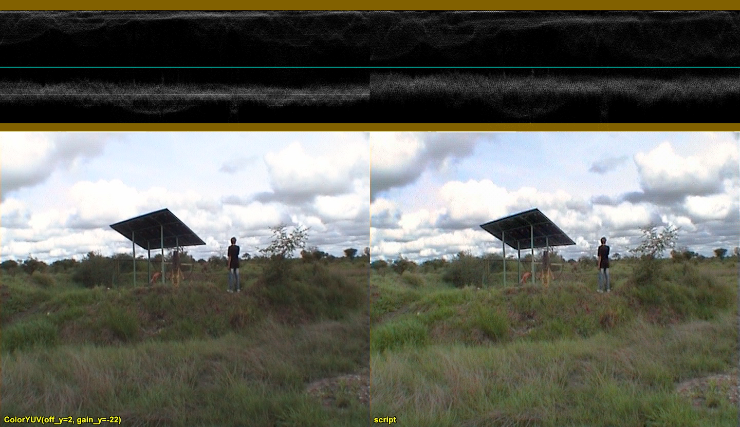

    I'm not following what exactly you did to get to the improved example? I know not to expect a be-all-and-end-all recipe, but it would be instructive to start off with what you did and play around with that, thanks.
    I started this correction a couple of days ago but was interrupted. Meanwhile, poisondeathray's post (#75) touched on the methods I used before I could post the results. I did this first with histograms and image filters in AfterEffects; but that's a bit unfair, as many people don't have AE or Color Finesse to play with, so I accomplished more or less the same thing in VirtualDub. Anyway, ColorYUV() and Levels() was the first step, to bring levels and chroma into a useable range.
    ColorYUV(off_y=-15)
    Levels(2, 0.95, 255, 10, 235, coring=false)
    As pdr noted, there are some things you can do in YUV (and which often you MUST do) before going to RGB to pinpoint more specific areas that you can't do with YUV (Well, no, I shouldn't say you can't do it in YUV, because I've seen people hit some very specific areas in YUV, but how they figured it out seems to be a totally undocumented secret). Given more time I would have got into the dither() plugin to help smooth some of the "spikes" in the spectrum, but I've seen dither introduce some unwanted effects. Probably worth a try, though.
    You remarked earlier that Levels() "changed some colors". True, but ColorYUV also "changes" some colors; both filters map them inside the preferred borders. Invalid chroma is as troublesome as invalid luma. The avs script reigned in lume+chroma. A YUV histogram of that code reveals an abrupt clipping point at RGB 220 or so. You can keep those brights below 255, but to no avail; practically speaking the original capture has no data above a certain point.
    Below: original levels. Left=YUV, right=RGB). The YUV histogram clearly shows hard bright clipping on the right, anemic black levels, and deficit of midtone values. The RGB histogram hsows the same thing, but here the color clipping and poor blacks are more clearly seen.
    [Attachment 16814 - Click to enlarge]
    Below: YUV levels adjust, Avisynth only. The YUV chart shows clippping, so bringing brights farther down offers no more detail. There is just a very slight creep into the below-RGB 16 area, but no detail down there anyway. The RGB histogram shows the obvious bright detail destruction in luma as well as chroma.
    [Attachment 16815 - Click to enlarge]
    Below: Adjust with gradation curves. Primary adjust (left) and secondary tweak (right). Could probably get those peaks smoothed with dither() and some contrast masking. Gradation curves raised the darker parts but kept blacks intact, and darkened bright clipped areas. No o0bvious banding, but note that the clouds have an abrupt cutoff above the shadow areas at about RGB 128 (from the midtones on up), and there's noise in the brighter colors. I'd opt for a better capture; the original IRE blacks are too high, and the image is too bright.
    [Attachment 16816 - Click to enlarge]
    Further RGB tweaks with ColorMill:
    MIDDLE POINT - Middle Point=-3,Booster=-56, Base Shift=0
    GAMMA - Red=3, Blue=3, Green=3
    LEVELS - Dark=-8, Middle=0, Light=5
    SATURATION - +5%
    I think my posted image has the cloud shadow a bit dark, but....it was getting late.

    In a NLE , you can do this with something like curves (adjust different regions, differently), but you have to be very careful, or you will get posterization effects when doing this on 8bit footage. Not to pick on Sanlyn, but you can see an example of that in the lower grey clouds, where the separatation is lost (it looks like "burnt grey")
    In this example with avisynth only, There is higher contrast in the clouds (the shapes are more discernable), and in the foreground - there is more "pop" to the image because the contrast is higher in both areas. The "flatter" the image, the more washed out it looks, especially when black is elevated. But sometimes you don't something like this - Sometimes those changes will distract the viewer's point of view or focus from the important part or the story you're trying to tell (I don't know what it is here, but you get the idea). You can look at the waveform and see the difference, the 2 "bands" representing clouds and foreground are more spread out. Anyways, the avisynth "trick" here was to use HDRAGC to selectively increase contrast in the foreground/grass regions (invert was used to apply it to the brighter cloud regions) . But it's hard to keyframe changes in avisynth...
    levels(0,1,255,0,237,false, dither=true)
    invert
    hdragc(max_gain=2, coef_sat=0.75)
    invert
    levels(12,1,255,0,255,false, dither=true)
    hdragc(max_gain=2, coef_sat=0.88)
    tweak(sat=1.2, coring=false)
    So the generic "learning point" here is to increase the contrast in 2 regions - spread out the data more to make use of more tonal range
