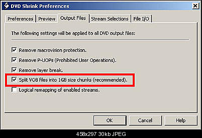

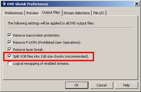

    There is a setting in dvd shrink that allows the creation of vobs larger then 1 gb. It could have been set by accident.

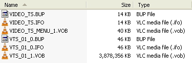

    I've run across some strange discs too over the years....here's one:

    Interesting theory, I tired DVD shrink with the 1 GB limitation, but it didn't work because the VOB file size given above in bytes is actually within limits:
    Divide by 1024 each time and you get:
    1,073,709,056 bytes = 1,048,544 Kilobytes = 1,023.9 Megabytes = 0.9999 Gigabytes
    Will try the one or two step re-encode as suggested.
