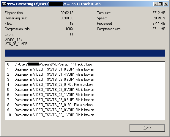

    In Isobuster I right-clicked on the optical drive then chose Extract DVD <Content> then the only enabled option Extract User Data ; there was also the option Extract DVD <Image> but I thought the one I chose was closest to what I'm used on DVDfab when Handbrake give me trouble: DVD Copy. At some point it alerted of an unreadable sector and it gave selections beside the usual retry & quit: omit sector skip, replace with all zeros & replace with dummy data ; I chose the 1st option after checking always apply selection.
    So it seemed to do good, it took hours to get through the DVD. It produced an .iso file which I opened with Handbrake but it gave me even less option than directly on the DVD. So I tried to first extract the .iso before having handbrake open its content folder but I had some errors, see attached, which state: Data error in 'FILE_NAME'. File is broken on extensions: bup, vob & ifo.
    So I still can't get past the error, I'd just like to have a program which could start ripping 1 minute after the error ; a software which I could specify the starting time of a title. Then I'd merge the resulting file with what I already got (stopping at error).
